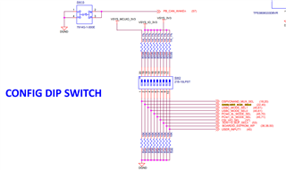

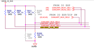

    In the code we have (perhaps unsuccessfully) changed the values of CANUART_MUX1_SEL0 and CANUART_MUX2_SEL0 in order to select the signals for SPI from the schematic.
    May i clearly know what changes have you performed ? Could you please elaborate me with any diagram on how you are accessing SPI5

    Can you please check whether you are calling SPI_test() from R5F core ? Usually the app under  vision_apps/apps/basic_demos are called from linux in A72 core rather than R5F core
    2)
    You need to configure the values as per above table to use respective port.

    2) From schematics extract from above, we should select B3 on both muxes. And from your table, i see there are three pins for each of the muxes, and in code I see only one pin selection (sel0) per mux (not sure why, if others are set somewhere else).. We will try to explicitly set all of them here (4 signals (of which is one set to HIGH in HW) control all 6)
    Milena
    More specifically, below is snippet from the kernel run function. And you can see in the UART log that these printouts start with "[MCU2_0]".
    okay understood.
    It is not default code, it was custom development. you need to control all the three mux to get the B3 port.

            // CANUART_MUX_SEL2 to level HIGH - set on BOARD PULLUP
    So, MUX_SEL0 goes into both multiplexers and should be set to high.
    In the schematic, it is connected to the config dip switch and we have set the 2nd dip switch to HIGH.
    We have also set the value in the expander to HIGH just to be sure.
    CANUART_MUX1_SEL1 and CANUART_MUX2_SEL1 have been set to LOW.
    CANUART_MUX_SEL2 is set to HIGH in HW as per schematic which is ok for our use case.
