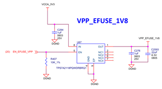

Hi expert,
Our customer is doing WCCA (Worst Condition Circuit Analysis) of TDA4VH. They found some conflicts. Could you please help to check if our understanding is right?
1. EN_EFUSE_VPP from TDA4 maybe exceed the input low threshold of TLV733.
TDA4VH:
TLV733:
2. The external CAN maybe exceed the input low threshold of TDA4.
