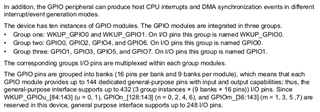

I referred to TRM,I see that gpio has three groups, mapped to 10 instances.  For example, WKUP_GPIO0 has a total of WKUP_GPIO0_[0,67]. Is it divided equally between WKUP_GPIO0 and WKUP_GPIO1?

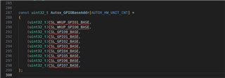

    So how to understanding there are ten instance of gpio modules?
    Or, in the sysconfig settings, there are only two instances of GPIO0: GPIO0/1, corresponding to the code: CSL_GPIO0_BASE/CSL_GPIO1_BASE?
    The wkup_gpio0 also have two instances: GPIO0/GPIO1, corresponding to the code:
    CSL_WKUP_GPIO0_BASE/CSL_WKUP_GPIO1_BASE?  If I don't assume this, then I won't be able to understand where GPIO2/3/4/5/6/7 comes from, because I don't see any introduction of GPIO2/3/4/5/6/7 in TRM and sysconfig.

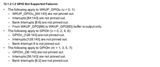

  • Hi Eason,
    Sorry for the delay in responses. Please take a look at these screenshots from the TRM:
    Additionally, if you take a look at section 5.3.3 of the datasheet there are only physical balls for pins within GPIO0 and GPIO1.
    As far as I can tell, the Use Case does not make a difference.
    Neehar
