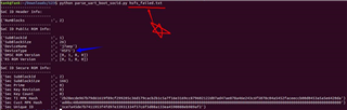

  • Hi Gokul
    Thanks for your reply.
    1.Yes, we've tried booting with the GP device, but it can not boot either.
    Because this board is installed with an HS-FS device, which can also be identified as an HS-FS device using the uart-parser tool.
    2.Sorry, our board do not yet support SD boot mode.
    3.This board has been successfully used for some time with eMMC boot mode.
    After re-flashing the eMMC once, this board can no longer boot from eMMC and always gets stuck before entering Uboot.
    BTW,
    We tried to use the UNIFLASH tool to flash the EMMC, but it was not successful.
    Best Regards!
    Tank

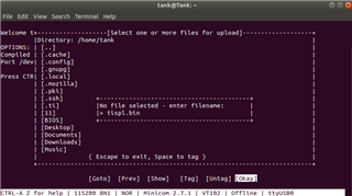

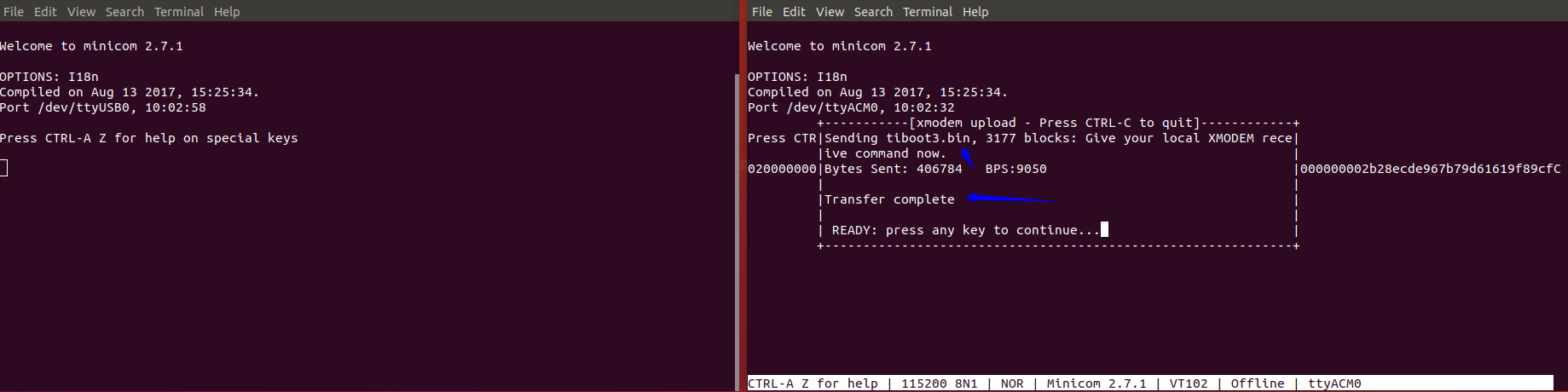

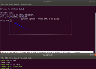

    Using UART BOOT mode was also unsuccessful.
    I followed the steps in the <TDA4VM-UART-Boot-faq> guide. But it's stuck on loading the tispl.bin file.
    7024.TDA4VM-UART-Boot-faq.pdf
    ps: The TDA4VH does not require a separate sysfw.itb file, so the above steps do not require loading the sysfw.itb file.
    Best Regards
    Tank

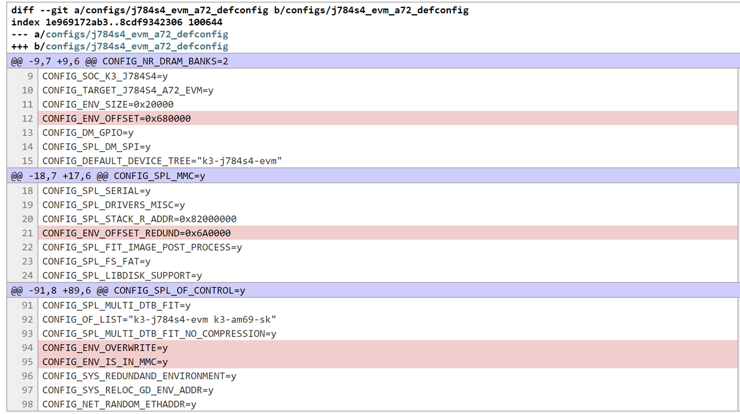

    Is this caused by the u-boot.img file downloaded into the system?
    Can it be changed to skip "Loading Environment from MMC" and directly"using default environment"?
    This may avoid this issue. Do you think so?
    Yes,skipping Loading Environment from MMC can solve the issue.
    Can you try applying the changes mentioned below and recompile UBoot . On doing this,you can skip "Loading Environment from MMC".
