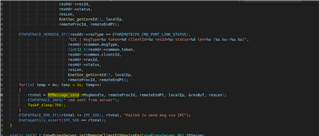

         I have built SDK9.2 version software for Ethfw and Vision apps for MCU2_0 (server) MCU2_1 (client),
case 1 : binaries from Ethfw build for MCU2_0 and MCU2_1 are working fine and able to communication through IPC and Ethernet TX and Rx are working on both Client and Server.
Case2 : MCU2_0 binary is from vision apps (platform build )  and MCU2_1 is from Ethfw (app_remoteconfig_client) here IPC handshake is not working to create virtual instances, could you please let us know what could be the issue? are these compatible with memory layouts?

  • Hi Sudheer,
              We are integrating the MAIN2_0 Ethfw to our own repository at that time i can see all ports are up but having issue creating virtual ports on MAIN2_1 core because of IPC Handshake issue.
    MAIN2_0 : Ethfw libriaries to our own repo (which is having simple dummy application)
    MAIN2_1 : build from SDK directly
    But if Server is sending IPC command messages multiple times client able to receive some of the packets, so what could be the issue with IPC how to resolve inconsistency of IPC communication between MAIN2_0 and MAIN2_1 ?
    Satya.
