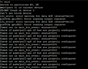

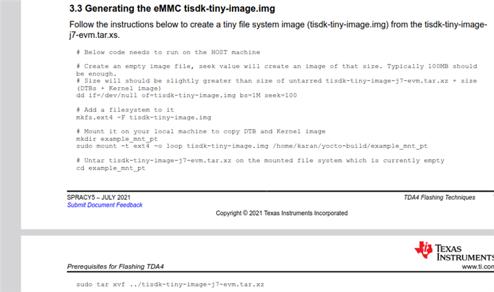

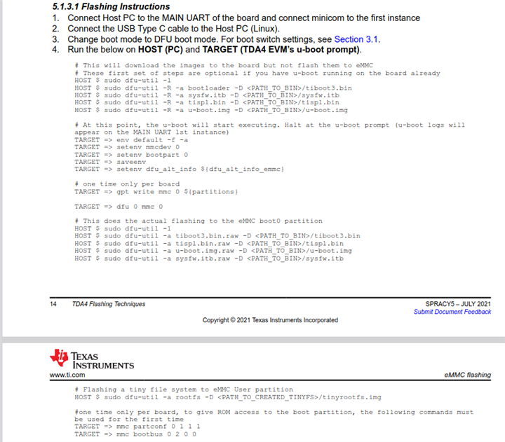

We download the latest SDK10_01 and want to verify PCIe functions based on this version. But follow the user's guide 3.1.1.5, we can not boot Linux from emmc.
https://software-dl.ti.com/jacinto7/esd/processor-sdk-linux-j784s4/10_01_00_05/exports/docs/linux/Foundational_Components/U-Boot/UG-Memory.html#
Has this guide been upgraded to 10_01? Could you provide more detailed operation steps?
