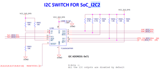

I would like to use the I2C2 bus, but I can't measure anything on the pins.

    Your pinmuxing for I2C looks appropriate to me. The I2C2 pinmuxing is identical to what we see in k3-am62x-sk-common.dtsi.
    To verify, you are NOT using the 40 pin automation header, right? But the 40 pin user expansion connector?
    Could you please attach your terminal output on boot so we can see what the I2C driver is doing on initialization?
    What do you see from the terminal when you do i2cdetect -y -r <bus_number>? I suspect that bus_number is NOT fixed, i.e., your hardware I2C0 instance may not align with your /dev/i2c-0 instance.

    root@phyboard-lyra-am62xx-3:dev# i2cdetect -y -r 0
         0  1  2  3  4  5  6  7  8  9  a  b  c  d  e  f
    00:                         -- -- -- -- -- -- -- --
    10: -- -- -- -- -- -- -- -- -- -- -- -- -- -- -- --
    20: -- -- -- -- -- -- -- -- -- -- -- -- -- -- -- --
    30: -- -- -- -- -- -- -- -- 38 -- -- -- -- -- -- UU
    40: -- -- -- -- -- -- -- -- -- -- -- -- -- -- -- --
    50: -- 51 -- -- -- -- -- -- -- -- -- -- -- -- -- --
    60: -- -- -- -- -- -- -- -- -- -- -- -- -- -- -- --
    70: -- -- -- -- -- -- -- --
    root@phyboard-lyra-am62xx-3:dev# i2cdetect -y -r 1
    10: -- -- -- -- -- -- -- -- -- -- -- 1b -- -- -- --
    20: -- -- UU -- -- -- -- -- -- -- -- -- -- -- -- --
    30: -- -- -- -- -- -- -- -- -- -- -- 3b -- -- -- 3f
    40: 40 -- -- -- -- 45 -- 47 48 -- -- -- 4c 4d -- --
    50: -- -- -- -- -- -- -- -- -- -- -- -- -- -- -- --
    60: -- -- 62 -- -- -- -- -- -- -- -- -- -- -- -- --
    root@phyboard-lyra-am62xx-3:dev# i2cdetect -y -r 2
    30: -- -- -- -- -- -- -- -- -- -- -- -- -- -- -- --
    70: -- 71 -- -- -- -- -- --

  • Hello Leon,
    I took another look at the schematic. Looks like there is an inline I2C switch that needs to be enabled in order to see the I2C signals at the user expansion connector:
    All the I2C outputs are disabled by default, so we'll need to add that switch to the Linux devicetree and enable output 0:
    Please refer to one of the device tree overlay files for a camera board. e.g.,
    /linux-5.10.168+gitAUTOINC+2c23e6c538-g2c23e6c538/arch/arm64/boot/dts/ti/k3-am625-sk-csi2-ov5640.dts
    Note that this is enabling output 1 to the CSI header, not output 0. So I would start by changing these 2 lines to say 0 instead of 1:
    &main_i2c2 {
            pinctrl-names = "default";
            pinctrl-0 = <&main_i2c2_pins_default>;
            #address-cells = <1>;
            #size-cells = <0>;
            status = "okay";
            clock-frequency = <400000>;
            i2c-switch@71 {
                    compatible = "nxp,pca9543";
                    #size-cells = <0>;
                    reg = <0x71>;
                    /* CAM port */
                    i2c@1 {   <<---------------------change to @0
                            #size-cells = <0>;
                            reg = <1>; <-------------change to <0>
                            // put your peripheral here
    Nick
  • Hello Nick,
    Thanks a lot, this worked!
    Kind regards,
    Leon
  • Hello Leon,
    Glad to hear that you were able to get it working! Were there any additional steps you needed to take other than placing the I2C peripheral node inside of i2c-switch{ i2c@0{peripheral_node}}?
    I will create an FAQ based on your input, since this additional step is not obvious without digging into the schematic.
    Nick
  • Hello Nick,
    I didn't try it with the device tree, instead I wrote a startup script which enables the switch for output 0 (i2cset -y 2 0x71 1) - I found it's simpler that way.
    Kind regards,
    Leon
