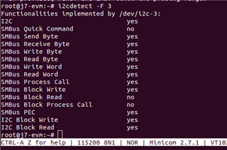

  • Hi Jared,
    Here I am attaching screenshots for the i2cdetect.
    thanks in advance
    Rejin

  • Hi Jared,
    Sorry for the delay. I am attaching the screenshot of i2cdetect
    I am using SDK version 8.06.01
