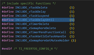

  • Hi Debashis,
    Thanks for sharing the above details.
    Please add the below macro definition to FreeRTOSConfig.h file located at ${MCU+SDK}/source/kernel/freertos/config/am62px/r5f.
    Please refer below image.
    Once the macro definition has been added, please rebuild the libraries. Run the below command from root directory of MCU+SDK.
    cd source/kernel/freertos/
    gmake -s -f makefile.am62px.r5f.ti-arm-clang PROFILE=debug clean
    gmake -s -f makefile.am62px.r5f.ti-arm-clang PROFILE=release clean
    After building the libraries, rebuild the example project. You will now be able to build it without errors.
    Please let us know if the above solution works.
    Tushar
  • Hi Tushar,
    Thanks for your support. It's working fine now. I have tried this, but as you said, I wasn't aware of the build.
    When I saw the tasks.c file, I could see that it's guarded with this macro, but I wasn't aware that we have to build this. Can you share any documents so I can read if any more info is there regarding RTOS? It's helping me out.
    Debashis
