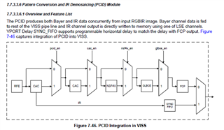

Do we need to enable PCID module for RGBIR working ?If yes what changes we need to do in single_cam application ?
Also how we can get the Bayer output and IR output as output from the ISP pipeline?
What all other changes we need to to do get a proper Bayer output or IR output in single_cam application?
    Yes, for RGBIR sensors, IR must be removed from the R/G/B pixels.
    PCID can only process up to 16-bit linear WDR images.
    What is the WDR format of your AR0823 output?
    As far as I know, AR0823 is up to 24-bit or 26-bit WDR.
    It varies with the use cases.
    VISS-PCID H/W may output up to 12-bit IR images with interpolation.
    Many customers would like to use the sensor raw output for IR frames without any PCID processing.

    If i want Bayer outputwhat changes i need to do? Similarly, if i want only IR output what changes i need to do in single_cam application?
    As per the TRM we can get either Bayer or IR using the switch block.
    For CAC ,NSF4V and GLBCE we have obj->viss_params.bypass_nsf4 ,obj->viss_params.bypass_glbce   variables in the single cam.If there any specific variable in the SDK which will do this switching (means Bayer output or IR output) ?
    You would need to enable PCID in this case (set bypass_pcid = 0).
    https://git.ti.com/cgit/processor-sdk/imaging/tree/kernels/hwa/vpac_viss/vx_vpac_viss_target.c?h=main#n608
    From the H/W perspective, PCID IR output can go out to DDR directly.
    That should be what the diagram shows.
    I am not familiar with the S/W details, it looks like "enable_ir_op" must be set for IR output.
    https://git.ti.com/cgit/processor-sdk/imaging/tree/kernels/hwa/vpac_viss/vx_vpac_viss_target.c?h=main#n1595
    Some format change may also be needed in application.
    https://git.ti.com/cgit/processor-sdk/imaging/tree/kernels/hwa/vpac_viss/vx_vpac_viss_target.c?h=main#n1952
