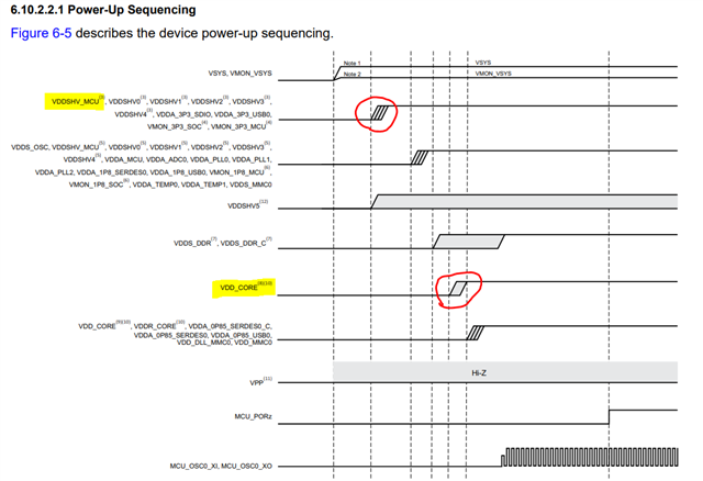

Is the shut down requirement the two points below?
- VDDR_CORE must power down before VDD_CORE
- VDDR_CORE potential must never exceed VDD_CORE+018V
So therefore, can power rails other than VDDR_CORE, VDDS_DDR, and VDDS_DDR_C can be powered down at the same time or after VDD_CORE?

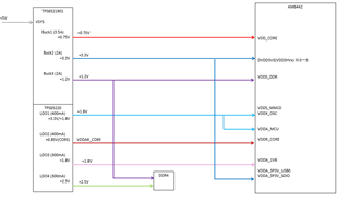

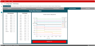

By default, the power sequence of the TPS6521901, BUCK1(+0.75V) powers down 10ms after BUCK2(+3.3V/+1.8V).
However, my customer wants to supply BUCK1 to VDD_CORE, BUCK2 to VDDSHV(0~5) of the AM6442.
VDDSHV will power down after VDD_CORE, but is this ok?
