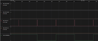

    This interrupt and callback does fire. The transfer status does not progress beyond the 'MCSPI_TRANSFER_STARTED'-state though. And is eventually cancelled.
    I also attached a logic analyzer to the MISO, MOSI, CS and CLK pins. The output is as follows:
    In the red, Chip Select is pulled active for a number of millseconds. This closely aligns with a 5th Data/Command pin that is controlled with a GPIO driver between SPI transfers. So I think at least the CS mechanism works. The clock is inactive though. And I can't see a clock setting beyond the frequency/bitrate in the LLD_MCSPI configuration structs. Is there a setting I am missing? Or should I change something in sysconfig?
