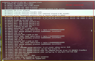

Hi, Dear Expert
Environment,
SDK 10.0
HW, AM62_LP_EVM & AM62A_LP_EVM
We follow this instruction to enter deep sleep mode.
https://software-dl.ti.com/processor-sdk-linux/esd/AM62AX/10_00_00/exports/docs/linux/Foundational_Components/Power_Management/pm_low_power_modes.html?highlight=sleep%20mode
echo mem > /sys/power/state
Our dump message as below,
But I think standard message as below.
[  230.181404] PM: suspend entry (deep)

It seems that we lost some log message,  does deep sleep work ok?
Or Do I miss something?
