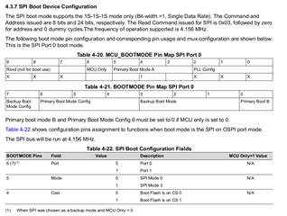

  • We can find some QSPI boot configuration described in table 4-10 when MCU_ONLY=0 : "PRIMAY BOOT MODE CONFIG(6..4)" being explained as  "PORT / RSVD / Csel" and Table 4-17 details PORT and Csel but we don't know what should be the value of RSVD. is it "dont'care" ? or should we force pin to '0' ? or '1' ?
  • when considering SPI boot (therefore with MCU_ONLY=0 and Primary_boot_mode_B_pin=1) we can refer to table 4-11 but the required value of "BACKUP_BOOT_MODE_CONFIG" is not given
==> is it "dont'care" ? or should we force pin to '0' ? or '1' ?
  • When considering SPI boot table 4-22 gives possible selection between mode 0 and mode 3 but I could not find any chrono-diagram explaining for each mode
    • which is the SPI clock edge activating Data output : rising ? or falling ?
    • which is the SPI clock edge capturing Data input : rising ? or falling ?
The datasheet gives some switching characteristics (figure 6-98 to 6-103) but t is not very clear which apply to mode 0, which apply to mode 3. ==> Can you explain more ?
  • When considering SPI boot we can see in table 4-1 that the only mentioned SOC peripheral is MCU_FSS0_OSPI0. However we can find in table 4-22 that either PORT0 or PORT1 can be chosen. Do you confirm that PORT1 does correspond to MCU_FSS0_OSPI1 ? which therefore should have been mentioned in table 4-1 ? or Am I mixing things ?
    I think the table should mention port for the back-up SPI config. I will confirm this and get back to you.

  • Hi Bruno,
    What I mentioned is correct. The pin 7 will control the port when in Back-up SPI mode. 0 corresponds to port 0 and 1 corresponds to port 1.
    Please see footnote in this :
    Mode 0 vs Mode 3 only corresponds to data sampling at the controller side and idle clock level. In Mode 0, data is sampled on leading edge and idle clock is low. In Mode 3, data is sampled on trailing edge and idle clock is high. I don't think there are any timing diagrams for this specifically in data sheet.
    You can take a look at the diagram here instead : https://e2e.ti.com/support/data-converters-group/data-converters/f/data-converters-forum/772490/faq-ads129x-what-are-the-correct-polarity-and-phase-cpol-cpha-spi-settings
    You are correct, Port 1 correspond to MCU_FSS0_OSPI1. It is missing from table 4-1. I will let the team know about this so that it could be corrected in future releases.

  • Hi Tanmay,
    I am a bit puzzled since the chrono diagrams you are referring to are from a slave perspective. this does not give idea of when is output the data from the MCU master , nor when the MCU_master samples the data.
    precise timing characteristics are necessary to calculate the maximum possible frequency, as well as the margins for a given frequency (for both MASTER writes and MASTER read)
