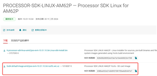

I'm Used SK-AM62P-LP Board, Download  SDK is ti-processor-sdk-linux-am62xx-evm-10.01.10.04-Linux-x86-Install.bin

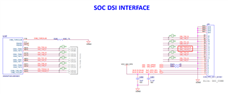

I use RPi DSI Panel ( EVM User's Guide SK-AM62P-LP.pdf  SOC DSI INTERFACE) To Connect EVM Board.

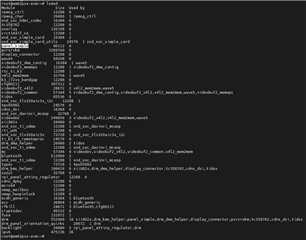

3. EVM Board power on, driver ko(tc358762, panel_simple, rpi_panel_attiny_regulator) is load ok
4. Test pin 14 of J25 with oscilloscope,no clock signal was measured。

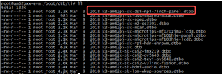

  • cd /boot/dtb/ti/
    cp k3-am62p5-sk-dsi-rpi-7inch-panel.dtbo k3-am62p5-sk-dsi-rpi-7inch-panel.dtbo.bak -rf
    cp k3-am62x-sk-hdmi-audio.dtbo k3-am62p5-sk-dsi-rpi-7inch-panel.dtbo -rf
    sync;reboot yes
     after linux kernel bootdone, hdmi is work ok, and lsmod

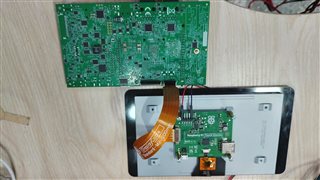

  • we bug fpc 22pin to 15 pin : https://www.amazon.com/dp/B0CN6WPYRH/ref=sspa_dk_hqp_detail_aax_0?psc=1
    but the raspberry-pi-touch-display The display screen only lights up the backlight and has no display。

    root@am62pxx-evm:~#

  • Okay, just to clarify, the backlight is up now because in your previous log the regulator wasn't coming up. I am assuming you have HDMI and DSI connected and if yes, you will see three cards under /dev/dri/card0, /dev/dri/card1 and /dev/dri/card2. If you want to see something on DSI display, run the command kmstest --device=/dev/dri/card2.
    Krunal
  • Dear Krunal.
    thanks for your great help. the command helps.
    Customer use SERDES to output to external display.
    Do we have similar sample code to support this use case?
    thanks a lot!
    yong
    We don't have any sample reference design for the above usecase.
    Krunal
