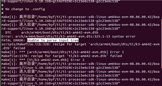

    We have looked at the example. The current maximum transmission bytes is 512. Now our requirement is to transfer files. Between Linux and rtos, we want to achieve large amounts of data access through shared memory access. Are there any examples in this regard?
      We use the rpmsg_char_zerocopy example under linux using SDK8.6. When modifying the device tree, we increase the dma buffer as mentioned in the README.md file, but an error occurs during compilation.Lines 111-115 and 325-327 are newly filled in according to requirements .

    When I include the file dma_buf_phys.h in the device tree it reports an error。like “arch/arm64/boot/dts/ti/k3-am642-evm.dts:13:10: fatal error: dma_buf_phys.h:
    #include <dma_buf_phys.h>
    compilation terminated.”
    What should I do if I want to use this example?
  • Hello Wanglili,
    Can you confirm which branch you are using?
    Please use the rpmsg_char_zerocopy branch named ti-linux-6.1 for SDKs 8.x and 9.x (kernel 5.10 & kernel 6.1).
    https://git.ti.com/cgit/rpmsg/rpmsg_char_zerocopy/
    Nick
      We have compiled and passed.Thank you very much for your answer.
