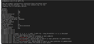

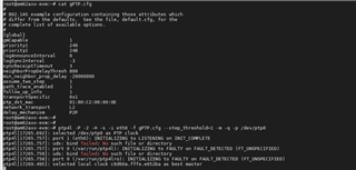

  • Although there is no failure to write the hardware timestamp through the ioctl, the time synchronization does not succeed either
    service:
    service
    client:
    client

    I assume the "service" output is from the PTP grandmaster device? If so, you should make sure the "priority1" is configured to 100. The follower device should be 240.
    Just to clarify, both connected devices are connected via their respective "eth0" ports?
    Can you do a tcpdump on the eth0 interfaces of both devices and see if you see the expected PTP messages (e.g. Peer_Delay_Req)?
    -Daolin
