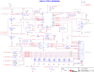

My main question is: does the AM69 support USB 3 Type-C lane swapping? Or should we add a mux to select which set of SuperSpeed signals are routed to a single SERDES lane?
Our current USB hardware configuration is based upon that of the SK-AM69 evaluation board with the following important differences:
  • USB Type-C is configured to operate with the DRD role.
  • SERDES 0 lane 3: One set of USB_SS_TX/RX signals from the Type-C connector
  • SERDES 0 lane 4: The other set of USB_SS_TX/RX signals from the Type-C connector
  • GPIO0_36: The USBC_DIR signal that is output by TUSB321
After experimenting with various device tree changes, a USB 3 Type-A to Type-C cable between a PC and the AM69 board behaves as follows:
  • In one Type-C connector orientation, the PC can communicate to the board at USB 3 speeds.
  • When the Type-C connector is flipped over, the PC can only communicate to the board at USB 2 speeds.
  • GPIO0_36 changes depending upon the orientation of the Type-C connector.
A USB 3 Type-A to Type-C cable only has one set of SuperSpeed signals, so they will either be connected to lane 3 or lane 4 of SERDES 0 depending upon the orientation of the cable.

  • My main question is: does the AM69 support USB 3 Type-C lane swapping? Or should we add a mux to select which set of SuperSpeed signals are routed to a single SERDES lane?
    The AM69 supports type-C lane swapping, however, the implementation is done by external ICs and not automatically supported by the IC.
    You could also refer to the J784S4 EVM for the type-C implementation.
  • Also note that USB3.0 has double muxing where it is connected to SERDES0 and SERDES4. USB_SERDES_MUX needs to select the right SERDES, in this case SERDES0 along with the SERDES0_ln3_ctrl.
  • Our circuit was very similar to the J784S4 EVM's Type-C implementation and we were using the correct SERDES, but I believe that we were running into some signal integrity issues. We were eventually able to get USB SuperSpeed working on different hardware that uses an external mux with only lane 3 of SERDES 0. Thank you, this can be considered to be resolved.
