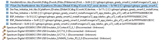

    and when the issue occures I open the CCS to connect the A72 core and found that the code was stuck in the
    and I go depth into the source code and I found that the failed was send by this function
