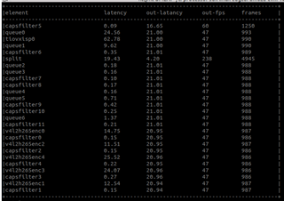

Currently, we are using four video streams with resolutions of 1216*864, 640*864, 448*608, and 1920*1080 respectively. When encoded by the encoder, the frame rate can reach 30 frames. However, when a new video stream with a resolution of 1920*1080 is added, making a total of five video streams, the output frame rate of the encoder drops to a maximum of 25 frames. Further verification tests have shown that it is possible to control two 1920*1080 video streams at 25 frames, while the other three can reach 30 frames, and vice versa. Therefore, we would like to confirm whether there is a software limitation on the encoder to control the frame rate and, if so, how to remove it? Our goal is to output all at 30 frames. Are there any other solutions?

  • Hi Quan,
    I tested 5 encoding pipeline with am62a which is almost the same with am62p except the encoding speed is 240Mp/s for am62a (lower than am62p 300Mp/s) and the fps is more than 40.
    GST_DEBUG_FILE=/run/trace.log GST_DEBUG_NO_COLOR=1 GST_DEBUG="GST_TRACER:7" GST_TRACERS="latency(flags=element)" gst-launch-1.0 -v v4l2src device=/dev/video-imx623-cam0 io-mode=dmabuf-import ! video/x-bayer, width=1920, height=1536, framerate=60/1, format=rggb12 ! queue leaky=2 ! \
    tiovxisp sink_0::device=/dev/v4l-imx623-subdev0 sensor-name=SENSOR_IMX623 wdr-enabled=true dcc-isp-file=/opt/imaging/imx623/dcc_viss_wdr.bin \
    sink_0::dcc-2a-file=/opt/imaging/imx623/dcc_2a_wdr.bin format-msb=11 sink_0::pool-size=8 src_0::pool-size=8 ! queue ! \
    video/x-raw, format=NV12, width=1920, height=1536, framerate=60/1 ! tiovxmultiscaler name=split \
    split. ! queue ! video/x-raw, format=NV12, width=1216, height=864, framerate=60/1 !  v4l2h265enc extra-controls="enc,prepend_sps_and_pps_to_idr=(int)30, video_gop_size=(int)30, video_bitrate=8000000" ! capsfilter caps="video/x-h265, profile=(string)main, level=(string)2.1" ! fakesink \
    split. ! queue ! video/x-raw, format=NV12, width=640, height=864, framerate=60/1 ! v4l2h265enc extra-controls="enc,prepend_sps_and_pps_to_idr=(int)30, video_gop_size=(int)30, video_bitrate=8000000" ! capsfilter caps="video/x-h265, profile=(string)main, level=(string)2.1" ! fakesink \
    split. ! queue ! video/x-raw, format=NV12, width=608, height=448, framerate=60/1 ! v4l2h265enc extra-controls="enc,prepend_sps_and_pps_to_idr=(int)30, video_gop_size=(int)30, video_bitrate=8000000" ! capsfilter caps="video/x-h265, profile=(string)main, level=(string)2.1" ! fakesink \
    split. ! queue ! video/x-raw, format=NV12, width=1920, height=1080, framerate=60/1 ! v4l2h265enc extra-controls="enc,prepend_sps_and_pps_to_idr=(int)30, video_gop_size=(int)30, video_bitrate=8000000" ! capsfilter caps="video/x-h265, profile=(string)main, level=(string)2.1" ! fakesink \
    Adam
  • Hi
    One more information. Set width=608, height=448 will work but width=448, height=608 will not work.
