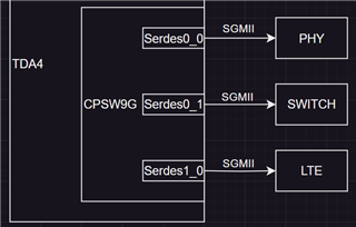

My current architecture is shown below. Is there a fixed mapping relationship between serdes and CPSW9G port index?
For example: serdes0_lane0 is mapped to CPSW9G port1. Or can all of this be configured via software? Is there a suggested mapping?

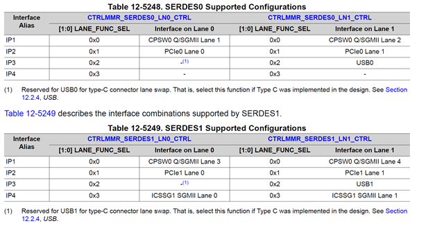

    It is a fixed mapping, only few SerDes supports CPSW functionality.
    Please refer to below SerDes0, Serdes1 (2 Lanes SerDes) mapping of CPSW Ports.
    SerDes0, LN0: CPSW Port-1,
    SerDes0, LN1: CPSW Port-2,
    SerDes1, LN0: CPSW Port-3,
    SerDes1, LN1: CPSW Port-4,

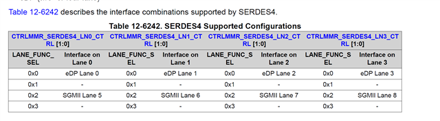

    Also, refer to 4 Lane Serdes, has mapping of remaining 4 Ports of CPSW (Port-5, 6, 7 ,8)
    TDA4VM has 5 SerDes supported, Four 2 Lane Serdes and One 4 Lane Serdes.
    Refer to TRM and Sysconfig tool for more details.
