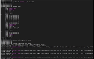

AM62A3: The application layer fails to receive UDP broadcast data because the udp port is not monitored
Part Number: AM62A3
Test environment:
User customized development board
Linux Kernel 6.6
TI SDK 10.1
The server sends an offer message (UDP broadcast data) through Someip SD, and the NIC can receive it, because I can capture it through the tcpdump instruction, but the port is not monitored, so the data is not transmitted to the upper layer, resulting in communication failure, I did the following test to verify, please refer to the following figure
How can the kernel or TCP/IP stack solve this problem?
    Can you please describe your test setup? (I.e. Is your custom board directly connected to a link partner or through a switch? Is the link partner a Linux PC, another EVM/board running Linux, or some other device?)
    Can you explain how you are determining the data is not transmitted to the upper layer? What is the communication error message you are seeing? I'm not seeing this information in your screenshot.
    -Daolin

    The above is the test program I wrote for verification, the client code udpclient.c is blocked in recvfrom, but through tcpdum -i eth0 udp port 30499, you can see that the board received UDP data broadcast packet, indicating that the data is sent to the network card, but not transmitted to the application layer. Then my board terminal executes the command ip addr add 239.127.3.1/24 dev eth0, the server and client can communicate, of course, I can also modify the above demo code, so that even without executing the above command can also communicate. I want to know where the board network configuration can be implemented like executing the command ip addr add 239.127.3.1/24 dev eth0
    Your inquiry appears to be more application-specific than a specific issue with the lower-level Ethernet (CPSW) driver. Please note that we do not offer specific support on application-specific inquiries and focus on supporting TI specific drivers. Application-specific issues like creating an application (in your case udpclient.c) to open a port to receive UDP packets are not specific to TI.
    One thing I can suggest is to check if in/proc/net/snmp, the expected UDP packets are incrementing in those statistics.
    -Daolin
