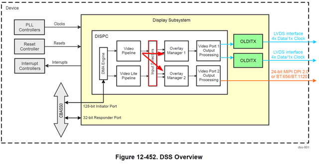

AM625: How to output dual channels with same content on SDK10.0.y using eglfs_kms plugin
Part Number: AM625
Tool/software: Linux SDK 10.00.07.04
On our customized AM6252 board, use dual display channels to display same content: one is OLDI and the other is RGB-to-HDMI, both resolution are 1920x1080.
1. On SDK 08.06.00.42, using the SDK default file system (QT5.14.2) and Kernel V5.10.y, can display dual channels simultaneously using the eglfs_kms plugin.
The configuration and execution steps are as follows:

root@am62xx-evm:/usr/share/qt5/examples/opengl/textures# ./textures -platform eglfs
2.Following the same steps as above on SDK 10.00.07.04 with SDK default file system (QT5.15.13) with Kernel V6.6.y, reports errors as below. The two channel display can't run up.

qt.qpa.eglfs.kms: "LVDS1" mode count: 1 crtc index: 0 crtc id: 38
qt.qpa.eglfs.kms: mode 0 1920 x 1080 @ 59 hz
qt.qpa.eglfs.kms: Selected mode 0 : 1920 x 1080 @ 59 hz for output "LVDS1"
qt.qpa.eglfs.kms: Physical size is QSizeF(344, 193) mm for output "LVDS1"
qt.qpa.eglfs.kms: Format is 34325258 requested_by_user = false for output "LVDS1"
qt.qpa.eglfs.kms: Output "LVDS1" framebuffer size is  QSize(1920, 1080)
