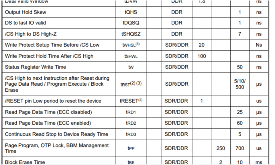

Hi Team,
I have tested the NAND flash performance test in the J722S board with SDK 10.01.
I tested the NAND with the PHY mode enabled, which means the PHY pattern is being flashed to the PHY partition. But observed the maximum throughput around 28 MB/s. Is this an expected value?
As per the data sheet of the NAND flash (W35N01xx) the maximum frequency it can support in SDR mode is 166MB/s. So if PHY mode is enabled we expected that the throughput should be as mentioned in the datasheet.
Could you please let me know why the throughput value is less even with the PHY mode is enabled?

    I discussed with our Nand expert.
    If you look into the same table:
    There is a read page (4K  Bytes) delay for every 4K. This can be between 25-60 uS. So that already reduces the theoretical bandwidth by less than half.
    Then we need to add software overhead from HLOS like Linux. We don't have the published numbers as of now due to the earlier bug fix we shared.
    From our understanding we should be getting close to 30M and which is almost what you are seeing.
