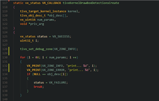

  • Hi Gokul,
    I modified tivxKernelDrawBoxDetectionsCreate() as you said.
    static vx_status VX_CALLBACK tivxKernelDrawBoxDetectionsCreate
        tivx_target_kernel_instance kernel,
        tivx_obj_desc_t *obj_desc[],
        vx_uint16 num_params,
        void *priv_arg
        vx_status status = VX_SUCCESS;
        uint32_t i;
        tivx_set_debug_zone(VX_ZONE_INFO);
        for (i = 0U; i < num_params; i ++)
            VX_PRINT(VX_ZONE_INFO, "print... %d", i);
            VX_PRINT(VX_ZONE_ERROR, "print... %d", i);
            if (NULL == obj_desc[i])
                status = VX_FAILURE;
                break;
        return(status);
    But still the message doesn't appear.

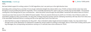

  • Hi Gokul,
    I have found this thread,
    https://e2e.ti.com/support/processors-group/processors/f/processors-forum/1442815/am62a3-how-to-view-the-logged-information-printed-in-the-c7x-dsp-after-connecting-to-the-board-via-ssh?tisearch=e2e-sitesearch&keymatch=C7%252520DSP%252520print#
    And following the answer, I executed  /opt/vx_app_arm_remote_log.out and I could see the prints from dsp.
    Thank you for the support.
