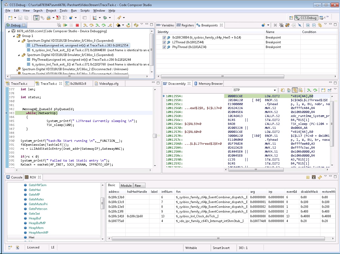

    I have checked ROV also and found INTR5 is generated for Core 0 and Core 1. The thread trying to open messageQ seems to be blocked on some Unknown as shown by ROV. As, I have debug its found that it lost somewhere in NameServerRemoteNotify. I have attached the code for both the cores core 0 and core 1.
    Please let me know if you need other information.
    Parshant
  • Parshant,
    I tried out your executables.  I notice that on Core0 [VideoStream.out] the eventId for the Ipc interrupt is set to 4.  This should be eventId 90.  Seems like something change this from the default provided by Ipc.  The default IPC Hwi vector is 5 with an event id of 90, but I see that for your executable is Hwi vector 4 with event Id 4.  The other executable [VideoPhyTest.out] is using Hwi vector 4 with the correct event Id 90.  You can see this in the Hwi module's  ROV "Basic" tab.  See attach file:

    Hi Judah,
    Thank you for the guidance.
    I have taken the observation as suggested by you but i have not seen such issue in the ROV data. I have found both core showing INTR 5 event ID 90 for IPC. Please see the file attached

  • Parshant,
    Okay, for some reason my ROV is not showing me the right stuff.  It could be that my BIOS/IPC version is newer and doesn't match your build.
    Concerning your problem, I looked at your *.c file.  You cannot call any XXX_open() from within the main() since those require interrupts to be enabled.  In main() global interrupts are not yet enabled.  You are calling HeapBufMP_open() in TraceInit() which is being called from main().
    Judah
