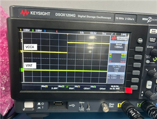

  • Hello Nicholas McNamara,

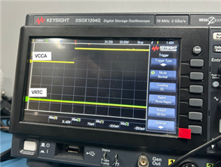

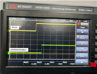

    I took the oscilloscope measurements, also gone through the TO_ACTIVE SEQUEENCE. These are the results:
    1) This result is between VCCA  & nPWRON/ENABLE and VCCA as a trigger source. Both signals are coming in PMIC. After Power ON from cold state, VCCA comes first then nPWRON/ENABLE comes after it. This reading shows PMIC inputs are enabled.
    2) This result is between VCCA & VINT. VCCA as a trigger source. No even instantaneous spike is observed in VINT when VCCA gets triggered after POWER ON from cold state.
    3) This result is between VCCA & VRTC. VCCA as a trigger source. No even instantaneous spike is observed in VRTC when VCCA gets triggered after POWER ON from cold state.

  • Hello Tanishq,

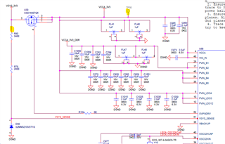

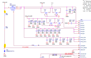

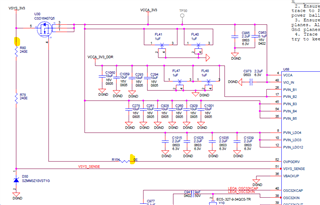

    Thank you for the oscilloscope shots, they help so very much. It looks like the VINT & VRTC LDOs aren't turning on, which doesn't make sense unless there are:
    1. Internal damage (quite unlikely)
    2. Shorts on the filtering capacitors
    3. VCCA measured is actually VSYS_3V3 (Most likely cause)

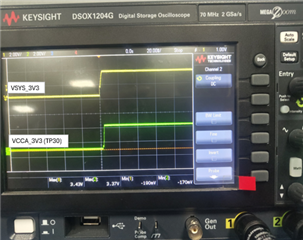

    There's a safety FET for this device and in the case of a failure from short test or from an Over Voltage Protection (OVP), you can read on this in the section labelled: 8.3 Feature Description 8.3.1 System Supply Voltage Monitor and Over-Voltage Protection
    In the datasheet. To confirm #3, please measure the following when applying power from a cold start.
    Trigger on 1. please if you can, this would demonstrate what exactly is going on during the power up process that would lead to a lock out event which would open the FET not allowing VCCA_3V3 through.
    1. VSYS_3V3
    2. VCCA_3V3 (TP30)
    3. OVPGDRV
    4. VSYS_SENSE (Between R78 & the diode)
    BR,
    Nicholas McNamara

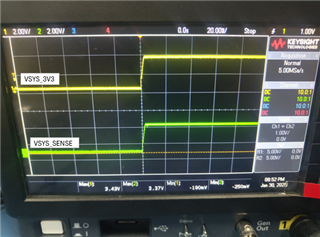

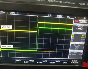

    I recorded the oscilloscope measurements. These are the results:
    1) This result is between VSYS_3V3 (tapped before R80)  & VCCA_3V3 (TP30) and VSYS_3V3 as a trigger source. Both signals are showing voltage levels. After Power ON from cold state, VSYS_3V3 comes first then after VCCA_3V3 comes after it.  VSYS_3V3 reads 3.43V and VCCA_3V3 reads 3.37V.
    2) This result is between VSYS_3V3 (tapped before R80)  & OVPGDRV (tapped before R154) and VSYS_3V3 as a trigger source. Both signals are showing voltage levels. After Power ON from cold state, VSYS_3V3 reads 3.35V and OVPGDRV reads 9.08V.
    According to this, OVPGDRV reads 9.08 as expected. calculated OVPGDRV = 0.9*3*3.35 = 9.045V
    3) This result is between VSYS_3V3 (tapped before R80)  & VSYS_SENSE (tapped between R78 & the diode) and VSYS_3V3 as a trigger source. Both signals are showing voltage levels. After Power ON from cold state, VSYS_3V3 reads 3.43V and VSYS_SENSE reads 3.37V.

  • Hello Processor Forum team,
    Thread Title: PMIC IC TPS6594133ARWERQ1 is not enabling due to faults n other board components.
    J784S4XG01EVM (TDA4AP, TDA4VP, TDA4AH, TDA4VH)
    Revision: PROC141E4
    PMIC: TPS6594133ARWERQ1
    Problem Statement: I am currently using the J784S4XG01EVM board for our POC development work and have encountered a significant hardware issue following an unexpected PMIC short circuit (TPS6594133ARWERQ1) problem.  After the power problem, I have observed only LD7 (VSYS_3V3), LD8(VSYS_MCUIO_3V3), LD9(VSYS_IO_3V3), only LD7 (VSYS_3V3) is enabled. since VSYS_MCUIO_3V3, VSYS_IO_3V3 is dependent on PMIC (TPS6594133ARWERQ1), I have replaced the faulty PMIC (TPS6594133ARWERQ1) and again tried to power the board. Again same issue persist, only LD7 (VSYS_3V3) is enabled.
    I registered a thread on TI E2E forum titled PMIC IC TPS6594133ARWERQ1 fails to Enable after replacing Faulty IC, No output detected from the IC for further diagnostics. The conclusion of this thread was that PMIC inputs are working as expected and PMIC is OK. There can be fault in the output side part/circuits of the PMIC on the EVM board due which is stopping PMIC from powering up.
    I kindly request processor team to help with further diagnostic and debugging to check if there is any fault in other parts of the EVM board due to which PMIC is not powering up.
