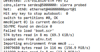

   For making emmc device to boot on power on, I followed the steps that mentioned in the SDK document given below,
https://software-dl.ti.com/jacinto7/esd/processor-sdk-linux-jacinto7/10_01_00_04/exports/docs/linux/How_to_Guides/Target/How_to_manually_flash_emmc_device.html
I followed the manually flash eMMC device. After following all the steps, I successfully boot the eMMC from u-boot. But I need to boot from eMMC on power on. What will be the sw8 and sw9 configuration for that. or we need to set any other switch.
I will attach the screenshots of booting from eMMC and SD card given below,
I am using J721E common board.
Rejin

  • Hi Gokul,
    1. I followed the steps 4.1.8.4 and also the next  step to boot from emmc.
    2. I checked with the two configuration ie emmc(user) and also emmc(boot). Both didn't work.
    3. I am using TI J721E EVM board.

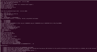

  • Hi Gokul,
    1. SDK version - 08.06.01
    2. boot-files.zip
    3.
    I created new SD card using the script mksdboot.sh located in the 8.06.01 SDK bin folder.
    For formatting and populating emmc I used guide from 10.0. While using 8.6.1 guide, I got error.
    This is the message I got when I use 8.6.1 for formatting and populating
    This is the message I got when I use 10.0 guide for formatting and populating
    Rejin

  • Hi Gokul,
    I tried the above steps but still its not booting from emmc. Now it checks only for mmc 1 if I changed the switch setting to emmc(user)mode.
    I am attaching the screenshot of that.
    regards,
    Rejin

  • Hi Gokul,
    Yes I am using 08.06.01 SDK. In log message we can see that it trying to access mmc1 ie it trying to access SD card.
    Rejin

  • HI Rejin,
    This screenshot which you attached indicates that it is booting fine on power-on(using switch settings for eMMC UDA) upto U-BOOT from eMMC User partition on for the 08_06 SDK .The "Trying to boot from MMC1" print in the above log indicates that it has successfully booted upto UBOOT from eMMC user partition.
    Now the only thing you need to try is once it comes upto UBoot ,try the following command :
    • This below command ensures that the kernel,dtbs and rootfs are taken from the EMMC user partition.
    => mmc partconf 0 1 7 1
    => mmc bootbus 0 2 0 0
    Note : This has to be entered everytime you enter U-BOOT in order to boot from eMMC.
    Gokul

  • Hi Gokul,
    I did the above mentioned step and it boot successfully. I am using SDK version 8.06.01.
    Latest SDK have also the same issue. The above step will not work in latest SDK(10.01).
    Rejin

  • Hi Gokul,
    Sorry to open this thread again. Currently I cannot boot from SD card. I changed the switch position but it not booting from SD card.
    Rejin
  • Hi Rejin,
    Do you have the logs of the same.
    Gokul
  • Hi Gokul,
    Here I am attaching the log file.

  • Hi Rejin,
    It is booting fine from SD card right(MMC2) as per the above logs.
    Gokul
  • Hi Gokul,
    Here we can see that mmc0 is used.
    Actually for proving I created a file in the root while my SD card is pulled out. I checked that location while SD card pulled in. In both case my file is there. So we can say that it still boot from emmc
    Rejin
  • Hi Rejin,
    That is because earlier we had executed the below command right to solve the booting from emmc issue.
    So,basically whenever we execute any setenv or savenv commands like below, the configuration will be saved to emmc,which is fine.
    Also,just one more thing to note.Since you had executed the above commands(ie:mmcdev,bootdev and boot part) earlier for booting from eMMC,u-boot takes the kernel,dtb and rootfs from eMMC.
    If you want to take the kernel,dtb and rootfs from SD,just execute the below commands upon entering u-boot.
    setenv mmcdev 1
    setenv bootdev 1
    setenv bootpart 1:2
    saveenv
    To revert back to eMMC for taking rootfs,kernel and dtb from eMMC,just execute the below commands,upon entering u-boot.
    Gokul
