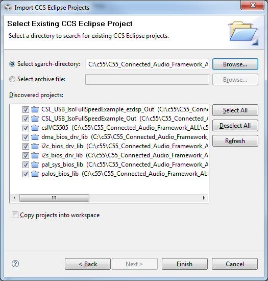

  • Hi Jeff,
    Lets try to get you up and running! It sounds like you did not import all of the projects.
    I am referring to build 01.52.01.00 for reference.
    When you open CCS, do you set your workspace to C:\c55\C55_Connected_Audio_Framework_ALL\c55-connected-audio-framework (or to equivalent path)?
    Next import all required projects by navigating to  File -> Import Project -> CCS -> Existing CCS...
    Next to the "Select search-directory" field, browse to the same c55-connected-audio-framework directory and click on OK.
    Several projects should be discovered and checked (like below).
    Click on Finish to exit from the Import Wizard.
    Next, right click on CSL_USB_IsoFullSpeedExample_ezdsp , and set it as the active project.
    Right click it and Build Project.
    For me, there are no errors.

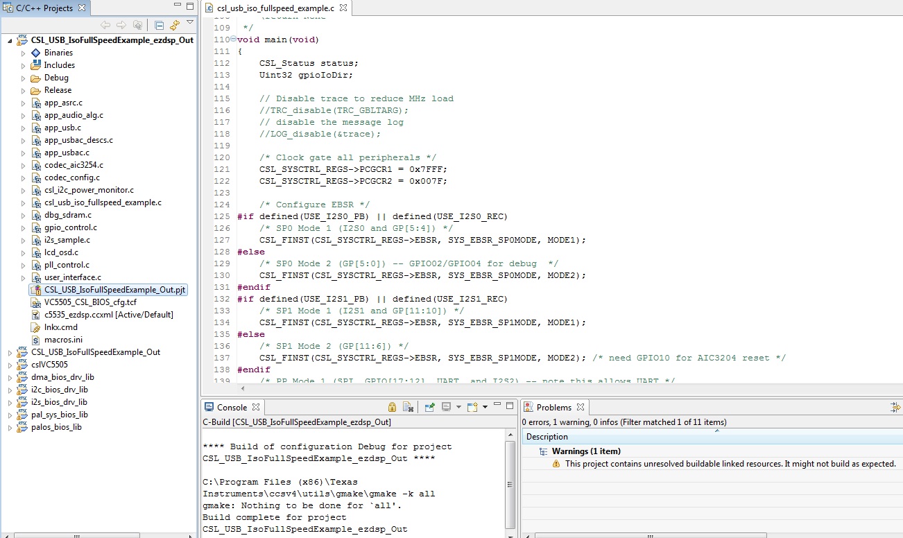

  • I still get the same error: I downloaded and installed the newer audioframework with this version: Product Info:
    Name C55_Connected_Audio_Framework
    Platform ALL
    Version 01.52.01.00
    Date Fri 10/28/2011
    Hash b2705c04b634227c0dcf25bbbf556ed8bda5b0e8
    I imported the project and it found the 8 listed ccs projects, I did a build all: and for every project it tells me *.pjt is still missing and for each project I get warning, this project contains unresolved buildable an linked resources. It may not build as expected.
    So I uninstalled CCS4.2.4 and reinstalled it and imported the projects again and it still gives me the same warning. I also installed on an entirely differnt machine that has windows XP and still get the same results.
  • Hi Jeff,
    This warning should be ignored.
    CSL_USB_IsoFullSpeedExample_Out.pjt is a project file used by CCS3.3.
    Since you are using CCS4.x, this file has no effect - the equivalent project information is contained in the .project, .ccsproject, .ctdproject, and .ctdbuild files.
    These are located under ...\c55-connected-audio-framework\build\CSL_USB_IsoFullSpeedExample_ezdsp_Out\
    To get rid of the warning, right click on the .pjt file (highlighted in your screenshot) and delete it from the project.
    OR
    Edit the .project file and remove these lines:
            <link>
                <name>CSL_USB_IsoFullSpeedExample_Out.pjt</name>
                <type>1</type>
                <locationURI>COMMON_ROOT/build/CSL_USB_IsoFullSpeedExample_Out.pjt</locationURI>
            </link>
    I will file a bug against this warning and post this information to the FAQ of the Connected Audio Framework FAQ:
    http://processors.wiki.ti.com/index.php/C5000_Connected_Audio_Framework#Frequently_Asked_Questions
    Mark

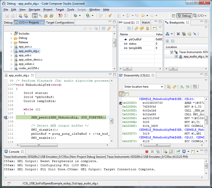

  • deleted project file and now no warring, however initial problem still there, can not see C source code in debugger, because symbol table or source files for BIOS are not linked?  not sure, all I get is dissassembly window.  I need to see OS source to be able to patch in a new task etc..
  • When you load the program, CCS should open csl_usb_iso_fullspeed_example.c and the blue arrow shows that the Program Counter is at the beginning of void main(void).
    You can view the C/C++ project files tab by clicking on View --> C/C++ Projects.
    Make sure that you are loading the .out file that was built with the Debug configuration and not the Release configuration or you will lose debugging ability. (your screen shot looks like it is Debug). You can right click on the .out file and view its properties to be certain.
    After loading the program, you can open a file and set a break point. When you run the program, execution should stop at your breakpoint. From there you may single step, watch variables, etc.
    In the screen shot below, I am showing how to set a breakpoint inside of the BIOS task TSK_PbAudioAlg inside of app_audio_alg.c. The breakpoint stops execution after DSP/BIOS executes this task. Breakpoint must be inside of the while loop.
    Hope this helps,
    Mark

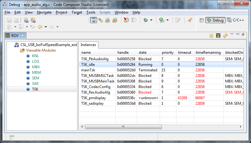

  • am I understanding this correctly?  I am supposed to manually open a C source file after Guessing what portion of the code is supposed to be running, then set a breakpoint, etc..   sounds pretty 2nd rate to me, all other tool set I have used. if you hit the run button, and then stop/pause execution, it (the tool) automatically loads the C source file so you can see where the code stopped,  currently CCS is not doing this for me.  as soon as I step out of main.c     I loose all ability to see anything.   Is my workspace or tool configuration missing something or set up wrong?   I would expect eclipse to operate the same as it does for other tools.  for example I use eclipse for designing C code inside of FPGA's and when I enter debug, it automatically finds the source code "C" file and opens it for me when I stop or pause the debugger from running.  and I can see exactly what function or subroutine I am currently in.  so it looks at the program counter, and goes and finds the C source file that matches where the program counter is currently pointing, I have verified that I am using the debug, output file, so there should be a symbol table and other "Un-Optimized" data there to link C source file to currently operating assembly instructions.  Are my debug settings incorrect??  In the attached picture, I just stepped through the main c file, and the program then jumps to DSP BIOS or RTOS and then I loose track of where code goes.
  • Hi Jeff,
    This project uses the DSP/BIOS operating system to switch between the various tasks that are run. DSP/BIOS is currently not open-source, so whenever you halt the program in an unknown state, it is very likely that the program counter is inside of these DSP/BIOS object-code routines.
    At 100MHz system clock, the utilization of the DSP is ~40% during audio playback and ~15% without audio. So there is a high probability that a halt during execution will stop inside of TSK_idle - no source code for this task.
    Also the Asynchronous Sample Rate Converter (ASRC) is provided as an object code library, so if you step through these instructions there will be no corresponding C-code displayed.
    You can step through the execution of the program by setting a breakpoint inside of the task that your are interested in - like TSK_PbAudioAlg.
    Alternately, you can view the state of DSP/BIOS after an execution halt by opening the ROV (Runtime Object Viewer). Open ROV by clicking on View -> Other -> Analysis Views -> ROV
    The screen shot below shows the ROV window indicating that the DSP/BIOS execution is inside of the TSK_idle (after randomly halting execution)...
