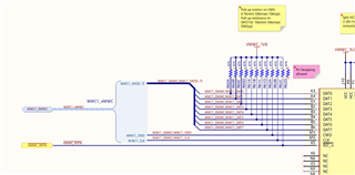

AM3352: eMMC not being detected by Linux but in uBoot
Part Number: AM3352
I'm having some trouble with the device tree enabling the eMMC on a custom board using the TI SDK 9.01. uBoot manages to find the eMMC memory, and the old OS based on Open Embedded works and detects the eMMC. Below is the logs and device tree. If any person has an idea what I can check further please let me know.
uBoot:

  • After some more debugging, I did notice from the schematic that there is a reset line for the eMMC on gpio1 20. This was not mapped to anything in the old device tree, and the new device tree I'm trying to port does not map that either. Is this now required?

  • Hi TJ,
    I see the Beaglebone Black board schematics also has gpio1_20 connected to eMMC RSTn pin, but the kernel devicetree doesn't map gpio1_20 either. So I don't think this reset pin is required.
    Regarding to the eMMC pinmux, I see your old devicetree uses "PIN_INPUT_PULLUP", but the new devicetree doesn't have "_PULLUP". Can you please add the "_PULLUP" in the kernel devicetree to see if it makes difference? Does your board have external pullup resisters on those eMMC pins?
  • Thank you very much. This solved the issue. Changing them to PULLUP in the pinmux fixed the issue. The eMMC does have external pullup resistors (as below), but this still fixed the issue.

  • Hi TJ,
    Glad to hear the issue is resolved. Thanks for the update.
    The Beaglebone Black board devicetree has the PULLUP configured on all the eMMC pins.
