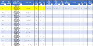

I'm using AM62B-P1 Starter Kit EVM. I wanted to enable the UART5: J3 40-pin connector, where 8th (E15_Txd) and 10th (C15_Rxd).

main_uart5_default_pins: main-uart5-default-pins {
bootph-all;
pinctrl-single,pins = <0x1d8 0x50002 0x1dc 0x10002>;
phandle = <0xdf>;

I've physically shorted 8 and 10th pins and did an echo test, but nothing came back. I don't exactly understand what the issue is. I see that UART5 is on, but when I did the loopback test, it didn't work with different baudrates.
