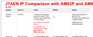

When viewing the comparison between AM62A and TDA4EN, I noticed that TDA4EN supports Histograms while AM62A does not. This leads me to believe that these are 2 different versions of C7x Subsystem:
questions:
1. what are the versions of C7x between these devices (it is not mentioned in the TRM)
2. what other C7x+MMA differences are there between these versions?
    Yes, you are correct that these C7x's are not identical. AM62A uses C7504 whereas TDA4AEN (architecturally, very similar to AM67A) uses C7524. This is generally not exposed because C7 is a closed architecture such that the low-level features are not directly accessible -- C7xMMA is treated as a black-box AI accelerator.
    That said, there are a few differences that impact the user-level
    • Increased L2 cache size (1.25 MB in AM62A vs. 2.25 MB in TDA4AEN)
    • Histogram / lookup table support in AEN, not present in AM62A. This mainly impacts nonlinear activations
    • 2nd C7xMMA on AEN -- each C7xMMA is a 256-bit variant that equates to 2 TOPS
