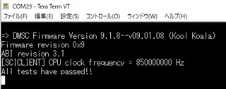

    Sorry for late reply. It took a while to confirm.
    I confirmed the following two things.
    It seems like there is a problem with SPL (Linux Boot). What do you think?
    1: Writing .out using QSPI NAND BOOT → Success
    I ran "Flash SOC Initialization Binary" and wrote to QSPI NAND with UART BOOT. After that, I changed to QSPI BOOT and started up, and was able to load .out from CCS.
    Log is below.
    C:\ti\mcu_plus_sdk_am62ax_10_01_00_33>cd tools\boot
    C:\ti\mcu_plus_sdk_am62ax_10_01_00_33\tools\boot>python uart_uniflash.py -p COM23 --cfg=sbl_prebuilt/am62ax-sk/default_sbl_null_hs_fs.cfg
    Parsing config file ...
    Parsing config file ... SUCCESS. Found 4 command(s) !!!
    Executing command 1 of 4 ...
    Found flash writer ... sending sbl_prebuilt/am62ax-sk/sbl_uart_uniflash_stage1.release.hs_fs.tiimage
    Sent flashwriter sbl_prebuilt/am62ax-sk/sbl_uart_uniflash_stage1.release.hs_fs.tiimage of size 259943 bytes in 27.1s.
    Executing command 2 of 4 ...
    Command arguments : --file=../../examples/drivers/boot/sbl_uart_uniflash_multistage/sbl_uart_uniflash_stage2/am62ax-sk/r5fss0-0_nortos/ti-arm-clang/sbl_uart_uniflash_stage2.release.appimage.hs_fs --operation=flash --flash-offset=0x0
    Sending ../../examples/drivers/boot/sbl_uart_uniflash_multistage/sbl_uart_uniflash_stage2/am62ax-sk/r5fss0-0_nortos/ti-aSending ../../examples/drivers/boot/sbl_uart_uniflash_multistage/sbl_uart_uniflash_stage2/am62ax-sk/r5fss0-0_nortos/ti-aSending ../../examples/drivers/boot/sbl_uart_uniflash_multistage/sbl_uart_uniflash_stage2/am62ax-sk/r5fss0-0_nortos/ti-aSending ../../examples/drivers/boot/sbl_uart_uniflash_multistage/sbl_uart_uniflash_stage2/am62ax-sk/r5fss0-0_nortos/ti-aSending ../../examples/drivers/boot/sbl_uart_uniflash_multistage/sbl_uart_uniflash_stage2/am62ax-sk/r5fss0-0_nortos/ti-aSending ../../examples/drivers/boot/sbl_uart_uniflash_multistage/sbl_uart_uniflash_stage2/am62ax-sk/r5fss0-0_nortos/ti-aSending ../../examples/drivers/boot/sbl_uart_uniflash_multistage/sbl_uart_uniflash_stage2/am62ax-sk/r5fss0-0_nortos/ti-a                                                                                                                        Sent ../../examples/drivers/boot/sbl_uart_uniflash_multistage/sbl_uart_uniflash_stage2/am62ax-sk/r5fss0-0_nortos/ti-arm-clang/sbl_uart_uniflash_stage2.release.appimage.hs_fs of size 132538 bytes in 15.85s.
    [STATUS] SUCCESS !!!
    Executing command 3 of 4 ...
    Command arguments : --file=sbl_prebuilt/am62ax-sk/sbl_null.release.hs_fs.tiimage --operation=flash --flash-offset=0x0
    Sent sbl_prebuilt/am62ax-sk/sbl_null.release.hs_fs.tiimage of size 302055 bytes in 31.27s.
    Executing command 4 of 4 ...
    Command arguments : --file=../../examples/hello_world/am62ax-sk/r5fss0-0_freertos/ti-arm-clang/hello_world.release.appimage.hs_fs --operation=flash --flash-offset=0xC0000
    Sending ../../examples/hello_world/am62ax-sk/r5fss0-0_freertos/ti-arm-clang/hello_world.release.appimage.hs_fs: 191394bySending ../../examples/hello_world/am62ax-sk/r5fss0-0_freertos/ti-arm-clang/hello_world.release.appimage.hs_fs: 191394bySending ../../examples/hello_world/am62ax-sk/r5fss0-0_freertos/ti-arm-clang/hello_world.release.appimage.hs_fs: 192423bySending ../../examples/hello_world/am62ax-sk/r5fss0-0_freertos/ti-arm-clang/hello_world.release.appimage.hs_fs: 192424bySending ../../examples/hello_world/am62ax-sk/r5fss0-0_freertos/ti-arm-clang/hello_world.release.appimage.hs_fs: 192425bySending ../../examples/hello_world/am62ax-sk/r5fss0-0_freertos/ti-arm-clang/hello_world.release.appimage.hs_fs: 192426bySending ../../examples/hello_world/am62ax-sk/r5fss0-0_freertos/ti-arm-clang/hello_world.release.appimage.hs_fs: 192427by                                                                                                                        Sent ../../examples/hello_world/am62ax-sk/r5fss0-0_freertos/ti-arm-clang/hello_world.release.appimage.hs_fs of size 190546 bytes in 20.76s.
    All commands from config file are executed !!!
    Starting NULL Bootloader ...
    SYSFW Firmware Version 10.1.8--v10.01.08 (Fiery Fox)
    SYSFW Firmware revision 0xa
    SYSFW ABI revision 4.0
    INFO: Bootloader_runCpu:176: CPU mcu-r5f is initialized to 800000000 Hz !!!
    INFO: Bootloader_runCpu:176: CPU a530-0 is initialized to 1400000000 Hz !!!
    INFO: Bootloader_runCpu:176: CPU a530-1 is initialized to 1400000000 Hz !!!
    INFO: Bootloader_runCpu:176: CPU a531-0 is initialized to 1400000000 Hz !!!
    INFO: Bootloader_runCpu:176: CPU a531-1 is initialized to 1400000000 Hz !!!
    INFO: Bootloader_runCpu:176: CPU c7x0-0 is initialized to 850000000 Hz !!!
    INFO: Bootloader_loadSelfCpu:229: CPU r5f0-0 is initialized to 800000000 Hz !!!
    INFO: Bootloader_JumpSelfCpu:248: All done, jumping self ...
    2: Writing .out using SPL (Linux Boot) → Successful but does not work.

  • Hi Tushar,
    Can you please tell which example are you trying to load? And which core are you using?
    "sciclient_get_version_am62ax-sk_c75ss0-0_freertos_ti-c7000" is Failed.
    "sciclient_get_version_am62ax-sk_mcu-r5fss0-0_nortos_ti-arm-clang" is Success.
    We would like to use C7x.
    O.H
  • Hi O.H.
    Please allow some time to replicate the issue and revert back.
    Tushar
  • Hi O.H.
    I have discussed this internally and got the information that the c7x examples will not be loaded via CCS when EVM is booted with Linux.
    Please boot the EVM via SBL binaries to load the example via CCS.
    Tushar
  • Hi Tushar,
    Thank you for your support. I understood.
    I'm hoping it will be fixed in the next SDK update.
    O.H
