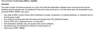

Further debugging revels that the issue is somehow related to ALE functionality. When the PTP sync is lost we see that following two counters are incremented
ale_drop: 37378
rx_port_mask_drop: 37378

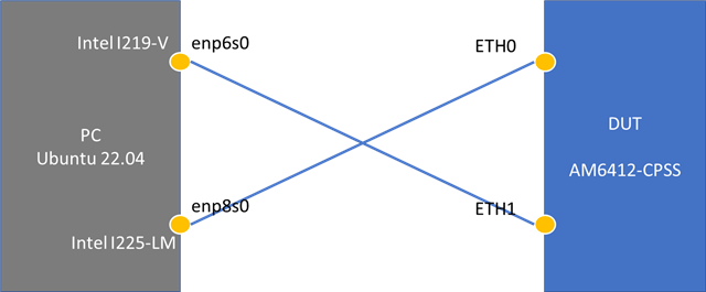

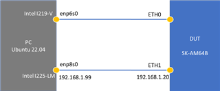

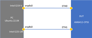

    1. We tested this in two topologies as given below (Blue box is the Device in test), all logs in this thread are based on topo 2.
    Topo 1:
    Topo 2:
    2. We are using CPSW driver for both ports on the DUT
    3. The PTP role doesn't matter, we observe issue in both cases i.e. DUT is PTP grandmaster or PTP follower.

  • Hi Dipal,
    Thanks for providing these additional details.
    Are you trying to test some sort of Ethernet redundancy scheme with topology 2 while running PTP?
    What happens if you had kept eth0 disconnected before running the ptp4l synchronization?
    DUT :      ptp4l -2 -P -H -i eth1   -m -q -l 7 -s
    PC  : sudo ptp4l -2 -P -H -i enp8s0 -m -q -l 7
    With these ptp4l options, if eth1 was disconnected instead of eth0, do you see similar log outputs? If possible, can you show the log for this case as well? I'm assuming instead of  "port1 (eth1): delay timeout" something like "port0 (eth0): delay timeout" would show up?
    Have you tried using "ptp4l -2 -P -H -i eth0 -i eth1 -m -q -l 7 -s" for DUT and "sudo ptp4l -2 -P -H  -i enp6s0 -i enp8s0 -m -q -l 7" for PC?
    -Daolin
  • Hi Daolin,
    We are not trying to us any redundancy, enp6s0 - ETH0 has no part in PTP, I just made this topo so that it is easy to test. However, we have observed same behavior in Topo 1 as well even through eth0 and eth1 are connected to completely different devices.
    If eth1 is disconnected, the PTP never recovers (there are no messages related to eth0), please find below the logs for both grand master and follower (DUT) for this scenario, check "<<<<" for annotations.
    I believe this will configure devices in PTP transparent clock which is not relevant to our scenario and the other link is merely used for ssh connection and it is not supposed to have any PTP running.

    When the sync is lost (after eth1 is made up again) we again see the same drop counters are incremented.
    root@ptp_test:~# ethtool -S eth1 | grep drop | grep -v ": 0"
    ale_drop: 1807
    rx_port_mask_drop: 1807
    root@smartnc-hwtest:~#
  • Hi Dipal,
    Thanks for this clarification
    This is a little confusing to me. I was under the impression that since eth1 is used in the ptp4l configuration, eth1 is a necessary interface to keep ptp synchronization running and that the issue lies in eth0 (unrelated to PTP configuration) being disconnected (not eth1 being disconnected).

  • HI Daolin,
    No problem, I realized later what you were trying to find out.
    So I update the topology as:
    Here are the logs:
    PC (PTP Grandmaster):
    [sudo] password for dze:

  • Hello Dipal,
    I ran the same ptp4l test on my setup of two AM64x EVMs connected eth0 to eth0 and eth1 to eth1 and configuring the eth1 interface in the ptp4l command. The Linux kernel I'm using the is the same as provided in the latest SDK RT-Linux 10.01 (kernel 6.6).
    DUT1 (AM64x EVM1) - PTP grandmaster
    root@am64xx-evm:~# ptp4l -2 -P -H -i eth1 -m -q -l 7
