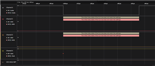

I connected a logic analyzer to monitor the SPI signals and observed that:
- CS pin is toggling LOW during communication.
No clock (SCLK) signal is generated.
I also tested SPI communication using a sample SPI test program, but no valid data is received from the flash chip.
Could you please review my device tree settings and help identify the root cause of why SPI communication is failing? I would appreciate any guidance on debugging this issue further.
