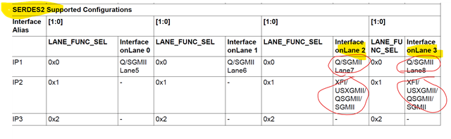

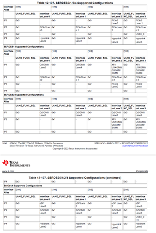

    Please find the below image, captured from TRM. (https://www.ti.com/lit/zip/spruj52)
    TI EVM has SerDes2 Lane2, Lane3 are mapped to ENET-EXP1 and ENET-EXP-2.
    If you look at SerDes2 Lane2 it can be configured either Port-7 (SGMII/XAUI/QSGMII) or Port-0 (USXGMII/XFI/SGMII/XAUI/QSGMII).
    By default RTOS ETHFW configured Port-1 in QSGMII Mode.
    Please can you clarify how SGMIIn relates to MAC_PORT_n?
    SGMII1 is MAC_Port1 i.e. SGMII and MAC Ports are mapped one to one.
    Above information will clarify all queries.
    Please refer to TRM shared above for more details.
    Sudheer

    I means lanes rom Serdes2 can be used for USXGMII as port-1, port-2 mapped to same SerDes lanes on different IP instance.
    I have corrected above statement.
    All ports supports QSGMII/SGMII/XAUI as mentioned above.
