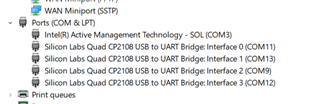

Hi, I have this board several weeks ago, I trying it boot it from SD card, I have follow the instructions, the image of OS writing to the SD card is success, and I have connect the power supply and HDM with screen, but noting showing there. I have some screenshot of what I got.
Thank you!

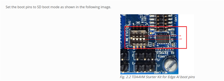

  • Hi Zhong,
    • Can you ensure that the switch settings that you have set on the board are as below:
    • Can you try the following command and check if the logs are coming:
    >sudo apt-get install minicom
    >sudo minicom -D /dev/ttyUSB2
  • Yes, I have tried and all other switch combinations, all not working

  • Thank you for your help, I have tried your steps, except in my computer is mmcblk0 not mmcblk1, then I only connect UART and power supply, the in terminal I have run "sudo minicom -D /dev/ttyUSB2 -c on", but it's looks like still can not boot.
    Screen is like
    Thank you!
