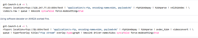

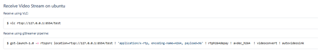

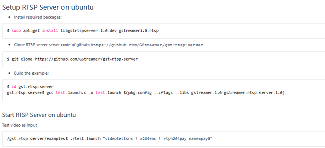

Dear Champs,
My customer is trying to display H.264 video in AM62A SK EVM with RTSP source from PC by referring below FAQ, but failed to display.
https://e2e.ti.com/support/processors-group/processors/f/processors-forum/1461875/faq-sk-am69-how-to-run-gstreamer-pipeline-with-rtsp-source

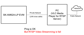

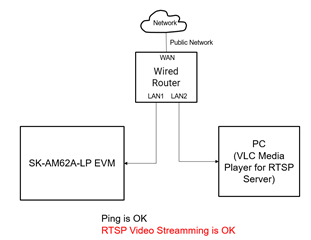

Their target is to streaming H.264 video streams through RTSP from PC to AM62A SK EVM, and decode it in AM62A SK EVM and display it through monitor connected to AM62A SK EVM, but failed with below log.
Could you please check below log and let me know how they can achieve it?
1. HW decoder
root@am62axx-evm:~# GST_DEBUG=3 gst-launch-1.0 rtspsrc location=rtsp://192.168.2.1:8554/test latency=0 proxy-id=None proxy-pw=None ! rtph264depay wait-for-keyframe=1 ! video/x-h264, stream-format=avc ! h264parse ! v4l2h264dec ! kmssink sync=false

Progress: (connect) Connecting to rtsp://192.168.2.1:8554/test
0:00:20.683569050  1412 0xffff7c000b70 ERROR                default gstrtspconnection.c:1156:gst_rtsp_connection_connect_with_response_usec: failed to connect: Could not connect to 192.168.2.1: Socket I
/O timed out
0:00:20.683697610  1412 0xffff7c000b70 ERROR                rtspsrc gstrtspsrc.c:5419:gst_rtsp_conninfo_connect:<rtspsrc0> Could not connect to server. (Timeout while waiting for server response)
0:00:20.683767140  1412 0xffff7c000b70 WARN                 rtspsrc gstrtspsrc.c:8364:gst_rtspsrc_retrieve_sdp:<rtspsrc0> error: Failed to connect. (Timeout while waiting for server response)
ERROR: from element /GstPipeline:pipeline0/GstRTSPSrc:rtspsrc0: Could not open resource for reading and writing.
Additional debug info:
/usr/src/debug/gstreamer1.0-plugins-good/1.22.12/gst/rtsp/gstrtspsrc.c(8364): gst_rtspsrc_retrieve_sdp (): /GstPipeline:pipeline0/GstRTSPSrc:rtspsrc0:
ERROR: pipeline doesn't want to preroll.
Setting pipeline to NULL ...
0:00:20.684122185  1412 0xffff7c000b70 WARN                 rtspsrc gstrtspsrc.c:8450:gst_rtspsrc_open:<rtspsrc0> can't get sdp
0:00:20.684242805  1412 0xffff7c000b70 WARN                 rtspsrc gstrtspsrc.c:6408:gst_rtspsrc_loop:<rtspsrc0> we are not connected
Freeing pipeline ..
