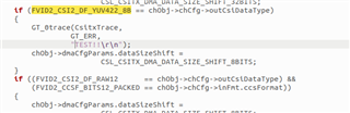

  • Hi Kim,
    no, unless you have set the error frame in the capture node. if capture node does not receive frame in frame time period, it would pass this error frame to the next component. But for this to work, you would have to set this error frame in the capture node..
    Looking at the CSITX implementation, it does support YUV422 format. But looking at the driver, i think there might be a small change required in the driver.
    In the API CsitxDrv_setDMACfgParams, in the file ti-processor-sdk-rtos-j721s2-evm-10_00_00_05\pdk_j721s2_10_00_00_27\packages\ti\drv\csitx\src\csitx_drvUdma.c, can you please make below highlighted change and see if it works?
    else if ((FVID2_CSI2_DF_YUV420_10B == chObj->chCfg->outCsiDataType) ||
    (FVID2_CSI2_DF_YUV422_10B == chObj->chCfg->outCsiDataType) ||
    (FVID2_CSI2_DF_YUV422_8B == chObj->chCfg->outCsiDataType) ||
    (FVID2_CSI2_DF_RAW10 == chObj->chCfg->outCsiDataType) ||
    (FVID2_CSI2_DF_RAW12 == chObj->chCfg->outCsiDataType) ||
    (FVID2_CSI2_DF_RAW14 == chObj->chCfg->outCsiDataType) ||
    (FVID2_CSI2_DF_RAW16 == chObj->chCfg->outCsiDataType) ||
    (FVID2_CSI2_DF_RGB888 == chObj->chCfg->outCsiDataType))
    chObj->dmaCfgParams.dataSizeShift =
    CSL_CSITX_DMA_DATA_SIZE_SHIFT_32BITS;
    if (FVID2_CSI2_DF_YUV422_8B == chObj->chCfg->outCsiDataType)
    CSL_CSITX_DMA_DATA_SIZE_SHIFT_8BITS;
    if ((FVID2_CSI2_DF_RAW12 == chObj->chCfg->outCsiDataType) &&
    (FVID2_CCSF_BITS12_PACKED == chObj->chCfg->inFmt.ccsFormat))

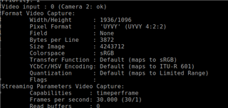

  • Hi
    I put a test pattern image into the CSITX node and checked the image on the receiving side.
    It looks like the images coming from the m2m node are not being passed along properly to the cstix node.

  • Hi Kim,
    But are you also sending the same frame size when using test pattern output?
    We might have to debug at the driver level to see if the parameters are getting configured correctly. Do you happen to have CCS and JTAG connected to this board? We can put some breakpoints to see if DMA is configured correctly first.
    Brijesh
  • Hi
    Yes, the test pattern is 1936x1096 uyvy format captured from gstreamer.

  • Hi Kim,
    Well, i want to check if the parameters are correct for the DMA.
    If not JTAG, can we add some prints and check the configuration?
    This will take few iterations, but will be required.

        75.339560 s: ISS: Starting sensor [IMX390-MAX9295] ... !!!
    Is this correct?
    Kim
  • Hi Kim,
    This frame size looks to be fine. 3872 is essentially 1936 x 2, which means pixels are 1936 and for yuv422, it requires 2 bytes per pixel. Frame height is set to be 1100, which is not correct as per your sensor configuration, but this should have caused artifacts.
    Let me see if there are few more parameters that needs to be dumped.

  • Not yet, still trying to figure out what can cause issue for YUV422 mode.
    Btw, can you also please check if there is nothing missing on receiving side?
    Brijesh
