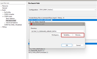

With CCS 12.8 I have some options when using variables to enter a path (include path, file search path, etc.), and let me at least see where it's pointing to
This is far from optimal, but at least I can see which are the variables that I can use and where it will lead to (if anywhere)
With CCS 20 that's still missing, and I'm left with just an entry box
From there I can blindly enter any nearly-correct nonsense, and I don't see where that's pointing to (if anywhere) -- especially when a path is defined by a chain of two or three variables.
