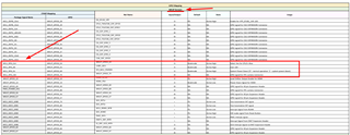

    I checked out the mentioned file and I added these to device tree.

    	mcu_spi1_pins_default: mcu_spi1-default-pins {
            pinctrl-single,pins = <
                J784S4_WKUP_IOPAD(0x038, PIN_INPUT, 0) /* (G38) MCU_SPI0_CLK */
                J784S4_WKUP_IOPAD(0x044, PIN_INPUT, 0) /* (F37) MCU_SPI0_CS0 */
                J784S4_WKUP_IOPAD(0x03c, PIN_INPUT, 0) /* (H36) MCU_SPI0_D0 */
                J784S4_WKUP_IOPAD(0x040, PIN_INPUT, 0) /* (J38) MCU_SPI0_D1 */

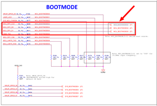

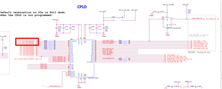

    I find out that MCU_SPI1_* pins are connected to CPLD.
    Could this be causing the freeze?
    What is CPLD?
    Tanmay
    I don't know much about the CPLD, all I know is that It is some kind of simplified FPGA.

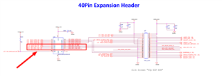

    MCU_SPI1_* pins are connected into CPLD and 40-pin header at same time.
    (AP)MCU_SPI1_* --> MCU_BOOTMODE_* --> CPLD and 40-pin header
