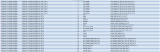

    I don't see how I'm supposed to know which entries in the input/output tables are PPIs, SPIs, or NVIC or VIM vectors. If you scroll down in the inputs table to line 209, here the Interrupt Id field seems to contain entries that correspond to the GIC SPI vectors.
    I am not sure if you are talking about line 209 without any filtering or if you had some filtering it would change.
    Here's a snapshot after I filtered the Instance for COMPUTE_CLUSTER0_GIC500SS
    The Interrupt Input Line is clear in idenfying which is a PPI, and which is a SPI.

  • The Interrupt Input Line is clear in idenfying which is a PPI, and which is a SPI.
    When I look at this, it seems to be missing information. The SPI entries do seem reasonably accurate and informative, but the PPI entries do not. At least, they don't appear to say what someone searching for PPI vector information would need to know.
    The GIC has 16 SGIs (software generated interrupts) 16 PPIs (processor-local peripheral interrupts) and some number of SPIs (shared peripheral interrupts), which can vary depending on the silicon implementation.
    As an OS developer, I want to know which peripherals are tied to which GIC vectors, because that tells you what interrupt service routine should be used to service an interrupt when it triggers.
    PPIs are core-specific, so the expectation is to have one list for each A72 core in the SoC. The most common use for them is to trigger interrupts from the Arm generic timer that's included with the core. The timer output on each core is connected back to the CPU through a PPI input in the GIC. There is a convention that the timer uses PPIs 26 through 29 in most implementations, but I think the silicon designer may be allowed to change it (which is why the vectors are usually specified in the device tree, where they can be customized for a given platform).
    There can also be additional PPIs depending on the chip design. For the TDA4VM, we can see that PPIs 16, 22, 23, 24, 25 and 30 are also used.
    The information you showed does not seem to include the PPI vector numbers. The Interrupt ID fields are all  0. The input line description and source interrupt descriptions also don't seem to yield any meaningful information about what those interrupts are actually for. I'm not actually sure what they're trying to tell me.
    If this spreadsheet is meant to be a replacement for the interrupt map tables, then I should be able to determine the same PPI vector values and sources that match what's in the corresponding table in the TDA4VM manual (except of course where the chip design differs). If I'm being really dumb and missing it somehow, then I apologize, but I really don't see it. I've searched for all cells that include "PPI" in them, and none of the hits make any reference to the Arm generic timer.
    I am sorry, but we won't be adding the tables back to the TRM.
    Well, if I'm right and the appendix spreadsheet is indeed missing the PPI information, then I think this must be corrected somehow.
    -Bill

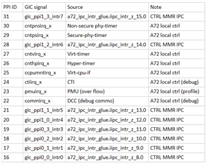

    Scanning documents (TDA4VH+XLS, TDA4VM, + feeding documents) the PPI mapping for each of the 8 A72s looks like this:
    It is similar to what is in the PPI ID mapping table in TDA4VM's TRM but it was extended to handle the new cores.
    The TDA4VH collateral should add in the mapping table.
    Richard W.
  • Sorry for the delay getting back to this, I've been stuck on a project which I've only just concluded.
    Does this means the TDA4VH documentation is indeed missing the PPI info and that TI will update it to correct this?
    -Bill
    I've included the data above.  A JIRA will be filed to capture.  It would be rolled into a future manual.
    Richard W.
  • Ok, thank you.
    -Bill
