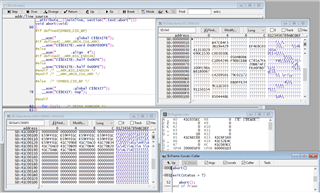

    I have remapped my SBL memory as per TI Demo SBL, now my SBL is verified by RBL and copied to RAM.

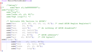

    After copying to RAM, i have an issue with Relocation of  CSL Vectors to ATCM.
    I have used following function to relocate vectors, referencing "utilsCopyVecs2ATcm.asm" from TI pdk
    Vector relocation is working when i use Debug_spinLock() function after startup
    If i disable Debug_spinLock() function after startup, my SBL is not working and going to exit/abort function.
    because of Vectors are not relocated to ATCM area.
    Issue: After power on Reset vectors are not relocating, when Debug_spinLock() is not using.
    Any hints here ?

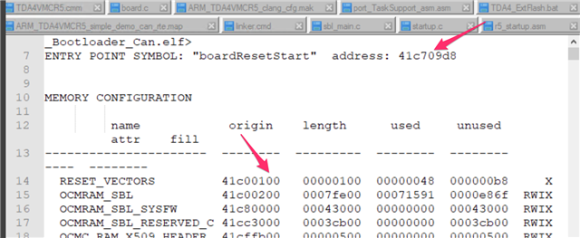

    Also, we see that the memory map you are using is violating some reserve sections as described here -->
    https://software-dl.ti.com/jacinto7/esd/processor-sdk-rtos-jacinto7/10_01_00_04/exports/docs/pdk_jacinto_10_01_00_25/docs/userguide/jacinto/boot/boot_k3.html#memory-map
    Regarding the vector relocation, the asm file  (& function RelocVect2Atcm) you use is not the one you must use.  Look at the sbl_main.c file where in line number 319, how it is taken care of by the standard SBL code.

    Now there is memory violation, and adapted Sbl demo memory map
    Still not working.
    Yes, _resetvectors are predefine, but reset vectors are not loaded at 0x00000000 by default.
    After Sbl startup, Sbl is copying reset vectors to 0x00000000(TCM memory)
    We are doing the same here.

    SBL on Can is working from external OSPI flash memory.
    I have identified root cause, TCMA memory is not enabled after reset.
    Now, in SBL startup, added a code to enable TCMA memory with reference to Ti SBL.
