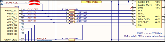

I have been working with our platform with OSPI interface and controlling a 256Mb SPI-NOR Quad device.

I can get spidev to work with the single line interaces such as main_spi0, 1 and 2.
For some reason cannot get spidev to work with the ospi interface.
Is this possible?
I ask because our design requires the use of spidev for development.
Thank you for your assistance.
Marc
  • When I enable the ospi interface and set the flash device to be spidev compatible I get a /dev/spidev0.0 node but cannot do anything with the interface.
    spidev cannot be used with the OSPI peripheral, as the error message suggests. It is not intended and designed for "basic" SPI-type operation.
    If the reason you are trying to use this that you need additional SPI interfaces, you can do the following:
    1. Use the software GPIO-bitbang SPI driver already in the Kernel, or
    2. Use a SPI peripheral from a different domain (MCU domain), or
    3. Use the PRU accelerator to implement your own custom SPI peripheral (we don't have specific sample code for this right now unfortunately, but one could start off with a related PRU-based example or driver. I think there's one for UART)
    Also the other error you got of " cadence-qspi fc40000.spi: couldn't determine phase-detect-selector" points to an important missing device tree property. Make sure you are using the correct/updated device-specific device tree files associated with SDK v10.1, and not older/earlier ones.
    Regards, Andreas
  • Hi Andreas,
    As my colleague mentioned, we successfully established communication using GPIO-SPIDEV and MTD. However, the main issue is that GPIO mode is extremely slow.
    We are designing a board with a Secure SPI NOR Flash chip that requires specific read/write commands and only accepts data in a particular encrypted format. This also makes MTD mode challenging to use.
    I modified the device tree to use OSPI in SPIDEV mode. While Linux recognized it as spidev0.0, no data was transmitted or received. Since the generic SPIDEV driver was removed from the Linux kernel, I used a known compatible device (spi-authenta, as it is also an SPI NOR chip). Here is my device tree:
    &ospi0 {
        status = "okay";
        pinctrl-names = "default";
        pinctrl-0 = <&ospi0_pins_default>;
        ti,pindir-d0-out-d1-in = <1>;
        spidev@0 {
            compatible = "spi-authenta";
            status = "okay";
            reg = <0>;
            spi-tx-bus-width = <1>;
            spi-rx-bus-width = <4>;
            cs-gpios = <&main_gpio0 11 GPIO_ACTIVE_HIGH>;
            spi-max-frequency = <25000000>;
            cdns,tshsl-ns = <60>;
            cdns,tsd2d-ns = <60>;
            cdns,tchsh-ns = <60>;
            cdns,tslch-ns = <60>;
            cdns,read-delay = <4>;
            cdns,phy-mode;
            spi-nor,ddr;
    Could you advise whether it is possible to interface with this chip in QSPI or OSPI mode using SPIDEV while leveraging hardware acceleration instead of GPIO?
    If not, is there a way to configure GPIO to utilize OSPI and transfer data over 4 or 8 lines?
    Thanks in advance for your guidance.
    Hossein
  • Could you advise whether it is possible to interface with this chip in QSPI or OSPI mode using SPIDEV while leveraging hardware acceleration instead of GPIO?
    No our QSPI/OSPI peripheral module cannot be used with spidev, this is not supported.
    I'm not sure what that means? Either you use GPIO, or OSPI. I'm not sure how GPIO "utilizing" OSPI would look like.
    How about you use your external device in single-wire SPI mode? And then use one of the McSPI peripheral modules (which will work w/ spidev)? I think this way you can get it to work much faster than any kind of GPIO-based bit-bang approach even using multiple signals.
    Regards, Andreas
  • No our QSPI/OSPI peripheral module cannot be used with spidev, this is not supported.
    What would be required to support spidev with QSPI/OSPI ?
    It is referring to use of GPIO SPI bit-bang driver to run in quad or octal mode to speed up the transfer of data because we cannot use spidev driver with cadence_qspi driver.
    This is difficult to do with the AM62x as the design is using the ability for the processor to boot from the QSPI.
    Booting is not a problem with accessing the SPI chip.  Our issue is around the access of the non standard "secure" registers in the SPI chip that there is no support for in the the kernel driver for.
    We have looked at implementing an MTD side channel to allow for raw data commands to be sent to the flash using the cadence_qspi.c driver but it all gets very difficult when dummy clock cycles are required to allow commands to execute in the SPI chip. The cadence_qspi driver supports a maximum of 31 dummy cycles where some "secure" commands require 40.
    The use of spidev to allow us to manage the chip is a tried and tested method as it gives us full control to data flow.
    We would really like to find a hardware accelerated method of interfacing to the SPI chip from linux kerenel instead of using the slow GPIO SPI driver.
  • Hi Marc,
    There is a "legacy mode" in the OSPI controller that *might* be able to do what you need from a HW POV, but there is no software infrastructure in the current driver for this, and this is like not something that can be developed in a non-trivial manner. Also see here...
    https://e2e.ti.com/support/processors-group/processors/f/processors-forum/1444100/am6421-more-flexible-use-of-the-ospi-interface/5538259#5538259
    https://e2e.ti.com/support/processors-group/processors/f/processors-forum/1444100/am6421-more-flexible-use-of-the-ospi-interface/5540138#5540138
    You would need to develop a completely custom bit-bang based driver for your memory device if you want to use more than 1-bit data. I don't think this can be achieved easily or cleanly by extending the existing GPIO bit-bang driver.
    The AM62x can technically boot from a regular SPI flash. So if you re-wire the connections that might work...
    1) Have ROM boot from your flash chip using the regular SPI interface,
    2) Once the Kernel is up, use spidev on top of the regular SPI interface
    If boot speed is a concern, you could do a hybrid approach as well, of wiring your flash chip to both the OSPI interface (for ROM boot) and the regular SPI interface (for post-boot usage) simultaneously.
    How does the vendor of this flash chip expect Linux users to use that device? Are there any drivers/reference code?
    How did you do that? Using the "STIG" mode?
    Regards, Andreas
