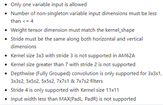

I noticed a difference between the documentation provided by edgeai_tidl_tools (edgeai-tidl-tools/docs/supported_ops_rts_versions.md at master · TexasInstruments/edgeai-tidl-tools · GitHub)
and the one I find in the file mmalib_cnn_convolve_row_ixx_ixx_oxx :
In mmalib_cnn_convolve_row_ixx_ixx_oxx, I noticed rectangular kernels are not supported while in edgeai_tidl_tools, nothing is written about it :
So, then, my question is what is the reason that rectangular kernels (e.g., 5*7) are not supported when configuring the use of kernels?

    mmalib_cnn_convolve_row_ixx_ixx_oxx is the function that implements CNN style 2D convolution on the MMA, (TI's matrix accelerator).  It only natively supports the convolution shapes described in the documentation.
    You are correct the same limitation could have been called out on edgeai-tidl-tools, but there are couple of options if you really need the rectangular filter size.  If using an open source runtime (i.e. ONNX),  you can keep the computation on the ARM (slower).  For more efficient computation, convert to a supported size.  For instance your 5x7 filter could be manipulated to be a 7x7 filter where the extra coefficient are set to zero (no retraining required!) and run on the MMA then.
