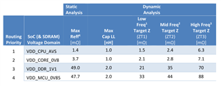

  • Can TI provide design specifications/guidelines that define number, placement, and type of capacitor for each power rail?  [TI - we already have that in our SK-AM69 EVM example, which you can use as a reference.  You can also refer to the TDA4-VH EVM example, as it is similar package/power requirements.]
    Are there any documents which specify capacitor type, value, and count for each power rail? [TI - again I would refer you to our existing hardware designs.  Those designs have been tested across process/temperature and are confirmed to meet an noise specifications.]
    Does TI provide PDN simulation models to validate power integrity?  [TI - We do not provide a model, but we do provide target impedance parameters for the higher current/low voltage power rails (VDD_CORE, VDD_CPU, VDD_MPU, etc).  We define targets for 3 different freq ranges for each rail.  Also - based on your power estimate for your use-case, you could generate a load step to ensure current to ensure you power delivery system keeps voltage/noise within specifications.]
    Does TI have any minimum ESL/ESR requirements for decoupling capacitors? [TI - No, we use 3terminal caps due to their lower package inductance (better performance), but if you can meet the power integrity specs with standard 2-term caps...then no issue.]
    Does TI have any application notes that can help with power delivery analysis? [TI - Link provides power integrity analysis information.  PPT also includes other information like LPDDR, High Speed IO, etc.  For these better to refer to the dedicated application notes.
