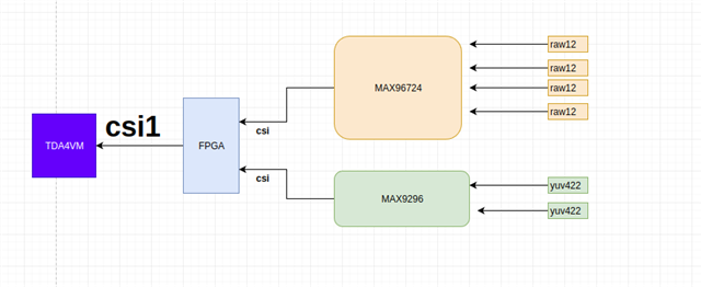

Hello TI experts,
SDK8.6,
We designed to collect 6 camera data on the CSI1 interface;
4 of them have RAW12 output format ;
2 of them have YUV422 output format;
#1 How to distinguish between raw12 and YUV422 in CSI1?
#2 Which files do we need to modify for CSI1 to work?
#3 Are there any relevant E2E thread references?
Looking forward to your reply, thank you
  • Hi Barry,
    Sorry, didn't get it. Data is distinguished using datatype, isn't it? You need to provide appropriate datatype for each channel.
    Just need to provide correct instance id in the CSI parameters and then channel to instance mapping pointing to this instance id.
    Brijesh
