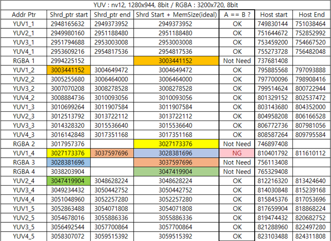

I feel that I did not phrase my previous question clearly, so I would like to ask it again more precisely.
My environment consists of QNX 7.0 and TI SDK 7.0, where applications operate independently as separate processes.
From my understanding, when two applications run in parallel, each host pointer maintains its own virtual memory address.
In this context, if 'host to shared' function is called under a race condition, could memory fragmentation occur?
For instance, suppose App1 utilizes NV12 (Y, UV) while App2 uses RGBA. Additionally, assume that both applications create an image buffer at approximately the same time.
Is it possible that App1's Y component is allocated to physical memory first, and before the UV component is assigned, RGBA is allocated to physical memory? This could result in the end address of the Y buffer and the start address of the UV buffer being non-contiguous.
To allocate NV12 images for QNX’s screen API, I require NV12 in a memory state that ensures contiguous allocation.
However, when multiple images are allocated under race conditions, I have observed frequent memory address fragmentation in the shared pointer.
I have attached a table summarizing my findings.
(A table is attached for easy analysis.)
YUV : nv12, 1280x944, 8bit / RGBA : 3200x720, 8bit
Addr Ptr Shrd_ptr start Shrd_ptr end Shrd Start + MemSize(ideal) A == B ? Host start Host End
YUV1_1 2948165632 2949373952 2949373952 OK 749830144 751038464
YUV2_1 2949980160 2951188480 2951188480 OK 751644672 752852992
YUV3_1 2951794688 2953003008 2953003008 OK 753459200 754667520
YUV4_1 2953609216 2954817536 2954817536 OK 755273728 756482048
RGBA 1 2994225152   3003441152 Not Need 737681408
YUV1_2 3003441152 3004649472 3004649472 OK 795885568 797093888
YUV2_2 3005255680 3006464000 3006464000 OK 797700096 798908416
YUV3_2 3007070208 3008278528 3008278528 OK 799514624 800722944
YUV4_2 3008884736 3010093056 3010093056 OK 801329152 802537472
YUV1_3 3010699264 3011907584 3011907584 OK 803143680 804352000
YUV2_3 3012513792 3013722112 3013722112 OK 804958208 806166528
YUV3_3 3014328320 3015536640 3015536640 OK 806772736 807981056
YUV4_3 3016142848 3017351168 3017351168 OK 808587264 809795584
RGBA 2 3017957376   3027173376 Not Need 746897408
YUV1_4 3027173376 3037597696 3028381696 NG 810401792 811610112
RGBA 3 3028381696   3037597696 Not Need 756113408
RGBA 4 3038203904   3047419904 Not Need 765329408
YUV2_4 3047419904 3048628224 3048628224 OK 812216320 813424640
YUV3_4 3049234432 3050442752 3050442752 OK 814030848 815239168
YUV4_4 3051048960 3052257280 3052257280 OK 815845376 817053696
YUV1_5 3052863488 3054071808 3054071808 OK 817659904 818868224
YUV2_5 3054678016 3055886336 3055886336 OK 819474432 820682752
YUV3_5 3056492544 3057700864 3057700864 OK 821288960 822497280
YUV4_5 3058307072 3059515392 3059515392 OK 823103488 824311808
    Thank you for detailed explanation
    this is a known issue and it has got fixed from sdk 7.3, check the implementation in $(PSDKRA)/tiovx/source/framework/vx_image.c
    please use the above mentioned sdk to solve this issue.
    attaching issue ID for reference,
    [TIOVX-773] Allocate single buffer for multiple planes in an image
