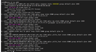

Hello
I have recently found that the network port sometimes fails to start and even freezes when using the AM62 self-made board.The SDK version 8.6 I am using has experienced this phenomenon with rootfs being default and buildroot.
Phenomenon: During the boot process, the network port is connected to the device for TCP communication. Occasionally, there may be abnormal startup of the connected network card, and both the buildroot and default rootfs are affected. The Dp83867 indicator light on the network port remains on and cannot be pinged. The network card cannot be queried by ifconfig in the buildroot system, but it can be viewed by ifconfig - a. In the default rootfs, the static IP cannot be displayed when the network cable is unplugged.
The two DMESG messages are as follows:; Eth0 appears on the busybox system, eth1 appears on the default system.
eth0
root@Moons:~# dmesg

  • Hello Hao Teng,
    Can you clarify (1) which network port is connected? (2) Is it just one network port that is connected when the issue is observed? (3) What is the "device" you are connecting to for TCP communication during bootup? (4) Do you have an EtherCAT master stack running on your custom AM62x board during boot up? (5) If so, is this issue only observed when EtherCAT is running during boot up?
    The point is to try and narrow down if this issue is a result of running EtherCAT or a result of a general Ethernet setup (with no industrial protocols running).
    SDK 8.6 is a much older TI SDK, to offer the best support I suggest you try out the latest SDK 10.1 if it is possible for you to do. Do you observe the same issue when using the latest SDK 10.1?
    Is this issue a different issue from the one you asked about here? https://e2e.ti.com/support/processors-group/processors/f/processors-forum/1464548/am625-about-ethernat
    The below sections of the boot log indicate to me one of the Ethernet ports is not detecting a corresponding PHY driver. Your device tree indicates that DP83867 PHY is also used for the port that is not detecting a PHY driver.
    [    1.498666] davinci_mdio 8000f00.mdio: phy[1]: device 8000f00.mdio:01, driver unknown
    [   15.267510] am65-cpsw-nuss 8000000.ethernet eth1: PHY [8000f00.mdio:01] driver [Generic PHY] (irq=POLL)
    [   15.267544] am65-cpsw-nuss 8000000.ethernet eth1: configuring for phy/rgmii-rxid link mode
    [   15.301383] Generic PHY 8000f00.mdio:01: Master/Slave resolution failed, maybe conflicting manual settings?
    	cpsw3g_phy1: ethernet-phy@1 {
    		reg = <1>;
    		ti,rx-internal-delay = <DP83867_RGMIIDCTL_2_00_NS>;
    		ti,fifo-depth = <DP83867_PHYCR_FIFO_DEPTH_4_B_NIB>;
    		ti,min-output-impedance;
    -Daolin
  • Hi, Daolin
    Thank you very much for your reply. This network port issue occurs simultaneously in eth0 and eth1.
    1)dmesg1 and Figure 1 are issues with eth0, while dmesg and Figure 2 are issues with eth1.
    2)The first uploaded dmesg1 only connected to one network port eth0, and the problem was also with eth0. I checked that dmesg did not see eth0 information during initialization, and when using IP addr, a noop state appeared.
    3)After booting into the application layer and using the service, a socket communication listener eth0 was opened, codesys, Modify Mac, etc
    4)After booting into the application layer and enabling the EC of codesys, sometimes the network port cannot be scanned. Upon entering Linux, it is found that the network card has not been initialized. Using ifconfig, active eth0 or eth1 network cards cannot be viewed
    5)Okay, I will not deploy the codesys main site for testing
    When developing based on am62, sdk8.6 was released, and many applications, libraries, and codesys had already chosen the cross compiler of 8.6. sdk9.0 had already replaced the cross compiler, and future projects will consider porting to the new version of sdk.
    The phenomenon I discovered during my last question is similar to the one in this question, except that the previous question directly provided some information. I have briefly checked the last issue and this time's dmesg1 and dmesg2, and the symptoms are that the network card is lost and unable to ping. After entering Linux, I found that the cause is different. The EC master station built by Codesys is started using scripts or services at the application layer. Upon checking DMESG, it appears that there is no information about network card connectivity issues during the initialization process.
    thanks
  • Hello Hao Teng,
    Just to clarify, you are saying once booted into Linux and before even starting CODESYS (at this point no other applications are running including CODESYS), you see the Ethernet interface was not initialized?
    -Daolin
  • Yes, after my repeated power on test, the main issues with the network port are as follows:
    [ 1.436336] davinci_mdio 8000f00.mdio: Configuring MDIO in manual mode
    [ 1.470016] davinci_mdio 8000f00.mdio: davinci mdio revision 9.7, bus freq 1000000
    [ 1.470310] mdio_bus 8000f00.mdio: MDIO device at address 0 is missing.
    [ 1.485789] davinci_mdio 8000f00.mdio: phy[1]: device 8000f00.mdio:01, driver TI DP83867
    [ 1.485899] am65-cpsw-nuss 8000000.ethernet: initializing am65 cpsw nuss version 0x6BA01103, cpsw version 0x6BA81103 Ports: 3 quirks:00000006
    [ 1.486272] am65-cpsw-nuss 8000000.ethernet: Use random MAC address
    [ 1.486284] am65-cpsw-nuss 8000000.ethernet: initialized cpsw ale version 1.5
    [ 1.486290] am65-cpsw-nuss 8000000.ethernet: ALE Table size 512
    [    1.464222] davinci_mdio 8000f00.mdio: Configuring MDIO in manual mode
    [    1.498056] davinci_mdio 8000f00.mdio: davinci mdio revision 9.7, bus freq 1000000
    [    1.507712] davinci_mdio 8000f00.mdio: phy[0]: device 8000f00.mdio:00, driver TI DP83867
    [    1.507730] davinci_mdio 8000f00.mdio: phy[1]: device 8000f00.mdio:01, driver unknown
    [    1.507851] am65-cpsw-nuss 8000000.ethernet: initializing am65 cpsw nuss version 0x6BA01103, cpsw version 0x6BA81103 Ports: 3 quirks:00000006
    [    1.508221] am65-cpsw-nuss 8000000.ethernet: Use random MAC address

    Since it is a self-made board, may it be related to the slow power supply time of dp83867? I am planning to test the power supply time of dp83867 and am62 simultaneously. Do you have any direction for troubleshooting? Thank you very much.
  • Hello Hao Teng,
    The first log you shared in the last response is for the busybox system and the second log is for the default SDK version?
    For the busybox system, can you check if the DP83867 PHY is kept in reset (i.e. check the reset pin on the PHY)? For the default SDK version, have you ensured the DP83867 PHY driver is enabled in the Kernel configuration?
    -Daolin
  • Thank you very much for your help. Once the reset pin is configured in the device tree, the problem can be solved.
