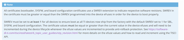

    1. Does TDA4 has rachet fuse to support rollback prevention? NO
    SWREV field in the Effuses used by the ROM and TIFS to support anti rollback protection.For more detail you can refer to the "K3 Security Hardware Architecture" present in secure resources.

    Is there a sample or reference guide for rollback protection?
    This feature is already getting used in the secure boot flow. Currently we are singing the bootloader,TIFS,secure board config with the SWREV =1. As the default value of the SWREV bits in the effuses is 1  on HS-SE production devices.
